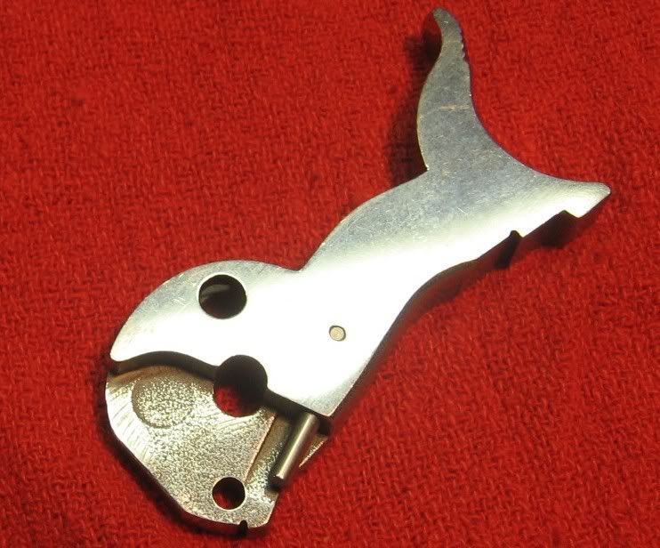

Dead Eye Raith Posted March 17, 2017 Author Posted March 17, 2017 Ok, I tested them and they do pinch. How do I weld up the hammer face? I'm a decent welder and what else is needed to remove the transfer bars? Quote
Boggus Deal #64218 Posted March 17, 2017 Posted March 17, 2017 Welding up the bottom of the hammers and cutting half cock notches in them. Quote
Dead Eye Raith Posted March 17, 2017 Author Posted March 17, 2017 Just now, Boggus Deal #64218 said: Welding up the bottom of the hammers and cutting half cock notches in them. Do you have to put half cock notches in them? What does that accomplish? Quote
Boggus Deal #64218 Posted March 17, 2017 Posted March 17, 2017 Simply put, the half cock notch holds the hammer back and lets the firing pin retract so that you can rotate the cylinder when it has cartridges in it. Otherwise. the firing pin will block the cylinder from rotating. Quote
twelve mile REB Posted March 17, 2017 Posted March 17, 2017 Boggus that is not always the case. A Ruger has a rebounding firing pin the reason for the spring around the firing pin several Blackhawks that I have owned and removed the transfer bar still loaded normally. That doesn't mean that it can not happen just that a half dozen I have owned or used did not have that problem. However, the NEED to only load five and rest the hammer on an empty seems very prudent under those circumstances. Quote
Driftwood Johnson, SASS #38283 Posted March 17, 2017 Posted March 17, 2017 (edited) Quote Simply put, the half cock notch holds the hammer back and lets the firing pin retract so that you can rotate the cylinder when it has cartridges in it. Otherwise. the firing pin will block the cylinder from rotating. Not quite. For the cylinder of any revolver to rotate, the bolt must be withdrawn down into the frame. Colt, Ruger, S&W, you name it. With a traditional lockwork such as in a Colt Single Action Army, cocking the hammer pulls the bolt down so the cylinder can rotate. That is the important thing, the bolt must be retracted into the frame for the cylinder to rotate for loading and unloading. When the hammer is pulled back to the half cock notch, the bolt is withdrawn into the frame so the cylinder can be rotated freely, for loading and unloading. The half cock notch merely keeps the hammer in that position, and the position of the hammer keeps the bolt down. When the hammer is pulled all the way back to full cock, the bolt pops up again and pops into the locking slots on the cylinder, locking the cylinder in battery so the gun can fire. With a modern transfer bar equipped Ruger, the hammer does the same thing, pulling the bolt down, allowing the cylinder to rotate and as the hammer gets close to full cock the bolt pops up again, locking the cylinder in place so the gun can fire. So far, there is no difference between the operation of the Colt and the New Model Ruger. The internal parts are different, but the results are the same. The difference comes in the relationship between the loading gate and the bolt on a Ruger. With a modern Ruger, opening up the loading gate also retracts the bolt into the frame, allowing the cylinder to rotate for loading and unloading. Since there is no half cock notch on the Ruger hammer, the only way to load it is to open the loading gate, which in turn retracts the bolt. If one were to remove the transfer bar from a modern Ruger, and weld up the hammer so it could strike the firing pin directly, the function of opening the loading gate to pull down the bolt so the cylinder can spin would remain. One could still load by opening the loading gate to free the cylinder to spin. My Ruger, with the Power Custom hammer, pictured above maintains this feature. I can either set it to half cock to load, or I can load it the way it was designed by opening the loading gate. What a half cock notch does is keep the hammer back far enough that the bolt remains retracted into the frame, so the cylinder can rotate for loading. Yes, allowing the firing pin to withdraw allows the cylinder to rotate if there are rounds in the gun, but if the cylinder is empty, it can rotate no matter what the position of the firing pin is. Regarding welding up the hammer and cutting a half cock notch your self, easier said than done. Welding up the hammer would be fairly easy, you can always grind down the weld if there is too much. Cutting a half cock notch is a different story. One would have to be very familiar with exactly where to cut the notch, how deep to cut it, and at what angle to cut it so the hammer would remain back far enough to keep the bolt retracted. Smiths who specialize in this have studied the action of the revolver and know exactly where and how much to cut. In addition, they usually have fixtures made up so they can make the same cut in the same place on hammers over and over again. Here is a stock Ruger hammer. The little semicircular cut at the bottom is the full cock notch. A half cock notch would need to be cut up near the base of the spring plunger. If you want to try cutting a half cock notch, you better buy several hammers to practice on until you get it right. Once you get it right, you can go ahead and do the easy part, welding up the hammer. Edited March 17, 2017 by Driftwood Johnson, SASS #38283 Quote

Abilene Slim SASS 81783 Posted March 17, 2017 Posted March 17, 2017 (edited) Power Custom half-cock hammer and trigger kits can be purchased and appear to be drop in parts if you purchase the entire kit. It appears from the look of the hammer that the transfer bar remains in place. Does this kit solve the infamous "Ruger-go-round" that occurs when the shooter's thumb slips of the hammer before it's fully cocked? Or is further 'smithing required to achieve that? Edited March 17, 2017 by Abilene Slim SASS 81783 Quote
McCandless Posted March 17, 2017 Posted March 17, 2017 52 minutes ago, Abilene Slim SASS 81783 said: Power Custom half-cock hammer and trigger kits can be purchased and appear to be drop in parts if you purchase the entire kit. It appears from the look of the hammer that the transfer bar remains in place. Does this kit solve the infamous "Ruger-go-round" that occurs when the shooter's thumb slips of the hammer before it's fully cocked? Or is further 'smithing required to achieve that? The Power Custom kits with the half-cock hammer will cure the "Ruger-Go Round", they are drop in. If you want the free spin pawl, there is some some minor modification to the transfer bar which is covered in the directions. Quote

Marauder SASS #13056 Posted March 17, 2017 Posted March 17, 2017 (edited) 20 hours ago, Dead Eye Raith said: Ok, I tested them and they do pinch. How do I weld up the hammer face? I'm a decent welder and what else is needed to remove the transfer bars? You do not need to weld the hammer. Instead you can take a little metal off of the hammer where the transfer bar rides when it is not activated. That is the slow below where the hammer actually hist the transfer bar when the trigger is held back. There is a lot of metal there and you normally need to take of just a few thousands. Look at Driftwood's post #18 to see the hammer. It is not the top part of the hammer, but the next notch down. Edited March 17, 2017 by Marauder SASS #13056 Clarification Quote
Procedural Pete Posted March 24, 2017 Posted March 24, 2017 Marauder, by filing the hammer are you referring to a cure for transfer bar pinch or allowing the removal of the transfer by filing the hammer rather than welding up the hammer? Quote
