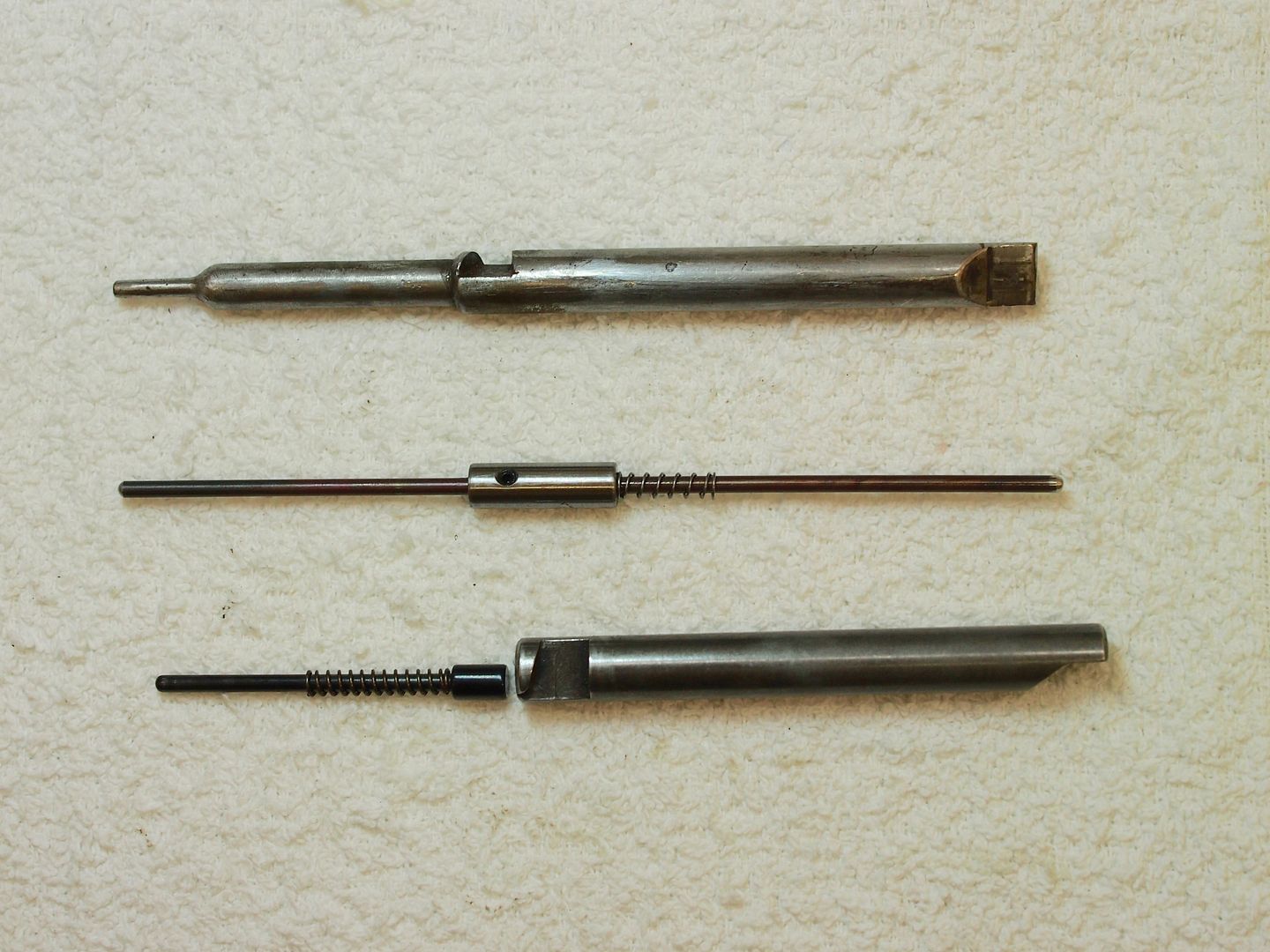

Larsen E. Pettifogger, SASS #32933 Posted December 31, 2015 Posted December 31, 2015 (edited) I haven't gotten my Chronicle but here is one of the pictures that I put in the article. Top is an original Winchester firing pin. Middle the one that is the subject of this post. Bottom is the Uberti set up. Everywhere there is a cut or angle there is a chance for breakage. On the Uberti they frequently break where the firing pin goes from large diameter to small as there is a 90 degree angle there. On the middle firing pin it is one STRAIGHT piece of steel with a collar slid on it for the firing pin spring to press on. There is basically nothing to break and if something did happen any machine shop with drill rod or tool steel stock could easily cut a new one. Â Edited December 31, 2015 by Larsen E. Pettifogger, SASS #32933 Quote
Silver Sam, SASS #34718L Posted December 31, 2015 Posted December 31, 2015 (edited) Larsen, In the photo, in relationship to the Winchester Original and the Uberti Original.... Isn't the new one piece reversed ???? Or the spring on the wrong side of the collar?? Edited December 31, 2015 by Silver Sam, SASS #34718L Quote
Larsen E. Pettifogger, SASS #32933 Posted December 31, 2015 Posted December 31, 2015 No. The article has around 50 photos and two or three thousand words of text. To much to recant here. Everyone is going to have to wait until they get the Chronicle (I'm still waiting!!!) because the article explains in detail how the new system works. It is different than anything most shooters would imagine. Quote

Silver Sam, SASS #34718L Posted December 31, 2015 Posted December 31, 2015 No. The article has around 50 photos and two or three thousand words of text. To much to recant here. Everyone is going to have to wait until they get the Chronicle (I'm still waiting!!!) because the article explains in detail how the new system works. It is different than anything most shooters would imagine. Very Interesting, Now I'm anxious to see the Article. Â Maybe the mailman will deliver my CC today............. Quote

The Polish Pistolero Posted December 31, 2015 Author Posted December 31, 2015 I haven't gotten my Chronicle but here is one of the pictures that I put in the article. Top is an original Winchester firing pin. Middle the one that is the subject of this post. Bottom is the Uberti set up. Everywhere there is a cut or angle there is a chance for breakage. On the Uberti they frequently break where the firing pin goes from large diameter to small as there is a 90 degree angle there. On the middle firing pin it is one STRAIGHT piece of steel with a collar slid on it for the firing pin spring to press on. There is basically nothing to break and if something did happen any machine shop with drill rod or tool steel stock could easily cut a new one. Â Â I like that explanation! Not knowing how it is built was my concern. I see how a part could be made if needed. Quote

Snakebite Posted January 1, 2016 Posted January 1, 2016 Looking forward to reading this article. I can't tell for sure from the photo's, but is the extension drilled and the new firing pin passed all the way through it? Â Snakebite Quote
Creek County Kid Posted January 1, 2016 Posted January 1, 2016 on this set up snake bite the extension becomes a bolt extension which is pinned to the bolt with a 3/32 roll pin and the firing pin goes through the extension and it the hammer strikes the firing pin instead of the extension and that's why you can run a lower main spring with this set up. It also allows for dry firing your rifle without fear of damaging the firing pin. I am going to post a video today on our facebook page and our youtube page will post a link on the wire so everyone can view about the pin with details on install and how the modification works inside the rifle. I am still working on the website should be up by the end of this next week ! Quote

Creek County Kid Posted January 1, 2016 Posted January 1, 2016 PaleWolfe the contour on the rear of the bolt extension does not change from that of a stock extension this was presented to Hipshot to be approved but was told there was no need to be approved due to the fact it was a internal modification and it could not be seen while the firearm was at rest (action closed ) provided they do not affect the external operation or directly conflict with one of the modifications listed. Quote
