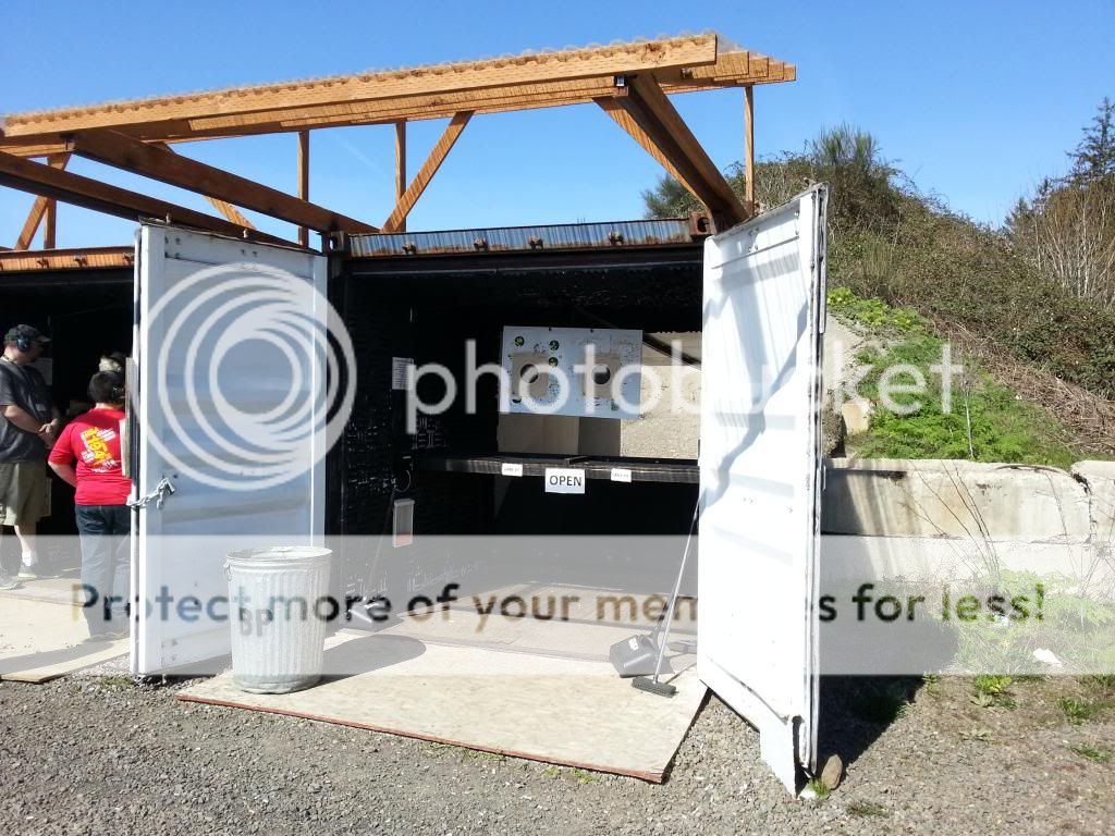

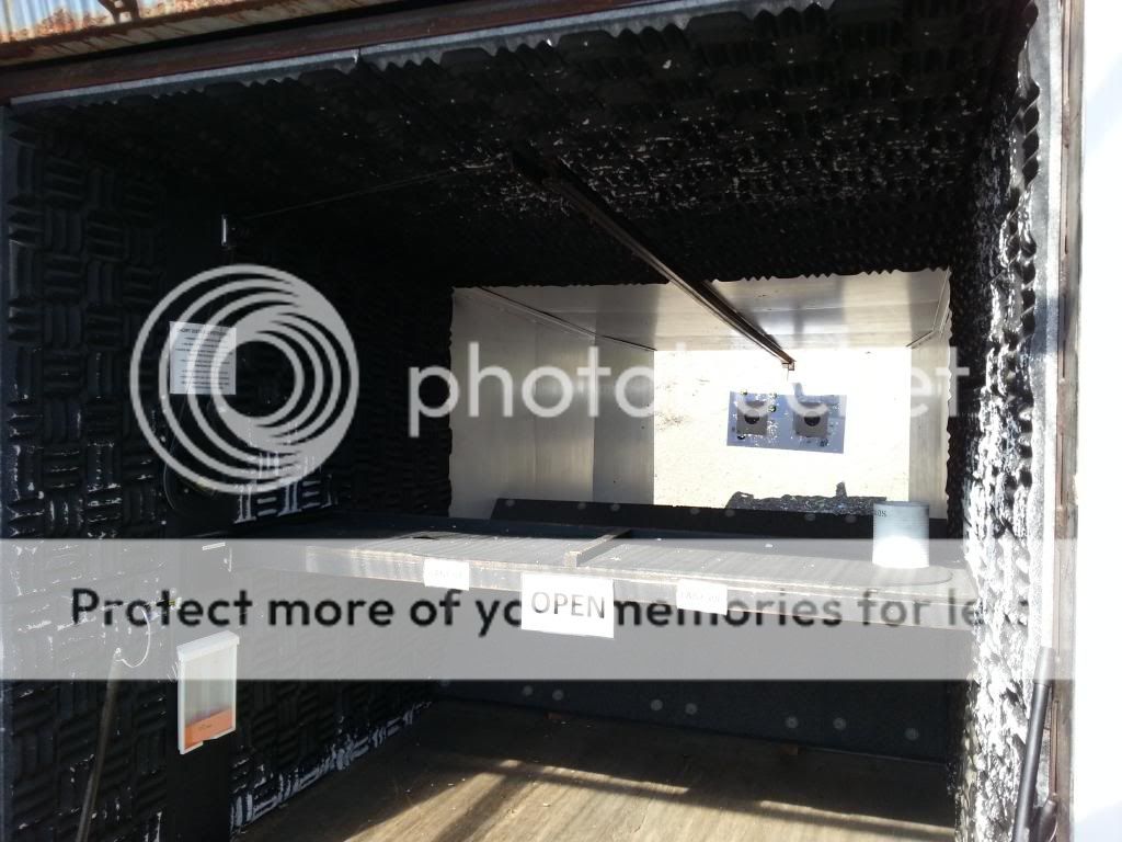

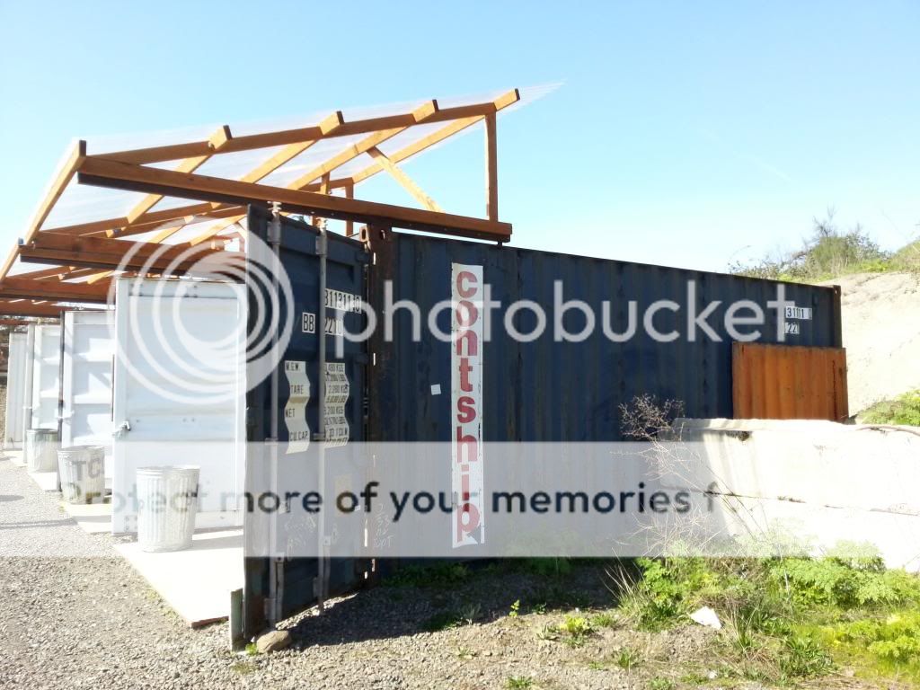

Key Hay Posted March 17, 2014 Posted March 17, 2014 How about a used shipping container with both ends open. TCGC has 4 in the action range. They keep rounds from leaving the club and the inside walls have some sound deadening and keep the sound down nicely. The berm at the end is high enough to prevent rounds from getting away. Lead splatter may be a different story.
