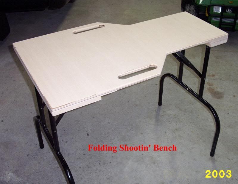

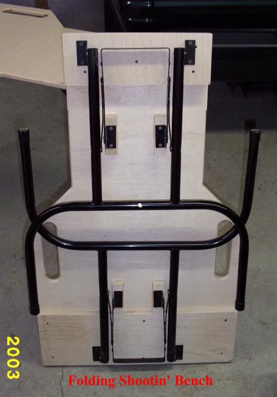

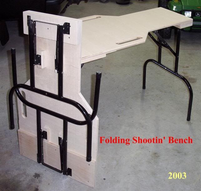

Deadeye Dingus Posted February 8, 2011 Posted February 8, 2011 I made several of these a few years back. Simple to make and inexpensive. Bought the folding table legs at Lowes. I used treated plywood just to improve the durability. I use 'em for shooting and sighting in out in the backyard and load 'em up and take 'em to Kansas every year to do some prairie doggin'. If I get this link hooked up correctly, there's even a drawing with measurements to work with. Have fun makin' one of these. Deadeye Dingus http://i1224.photobucket.com/albums/ee364/DeadeyeDingus/FoldingBench1-1.jpg http://i1224.photobucket.com/albums/ee364/DeadeyeDingus/FoldingBench2.jpg http://i1224.photobucket.com/albums/ee364/DeadeyeDingus/FoldingBench3.jpg http://i1224.photobucket.com/albums/ee364/DeadeyeDingus/FoldingShootinBench.jpg
