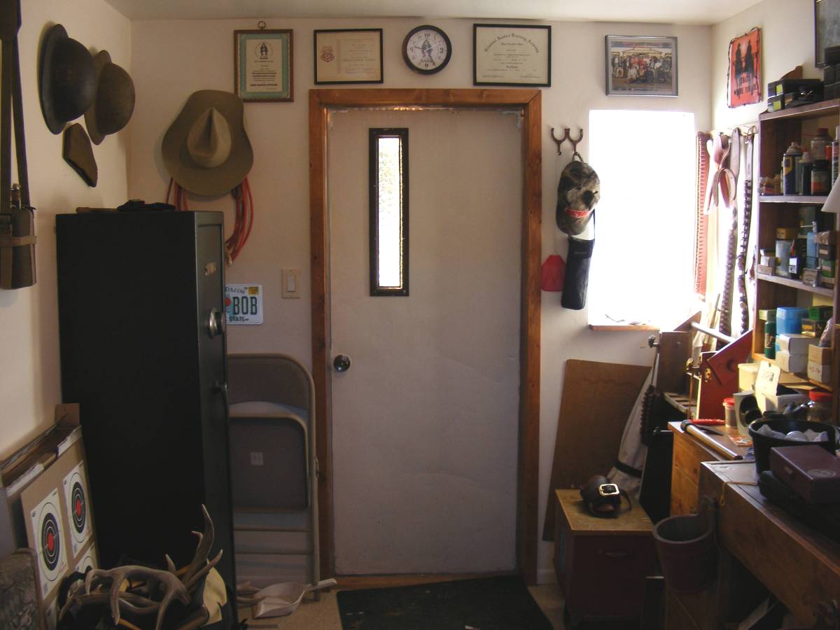

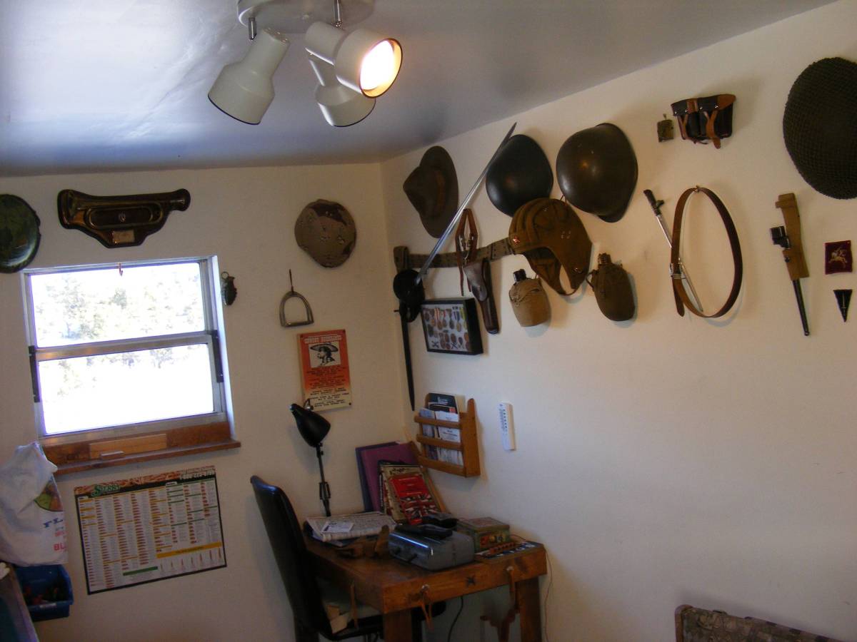

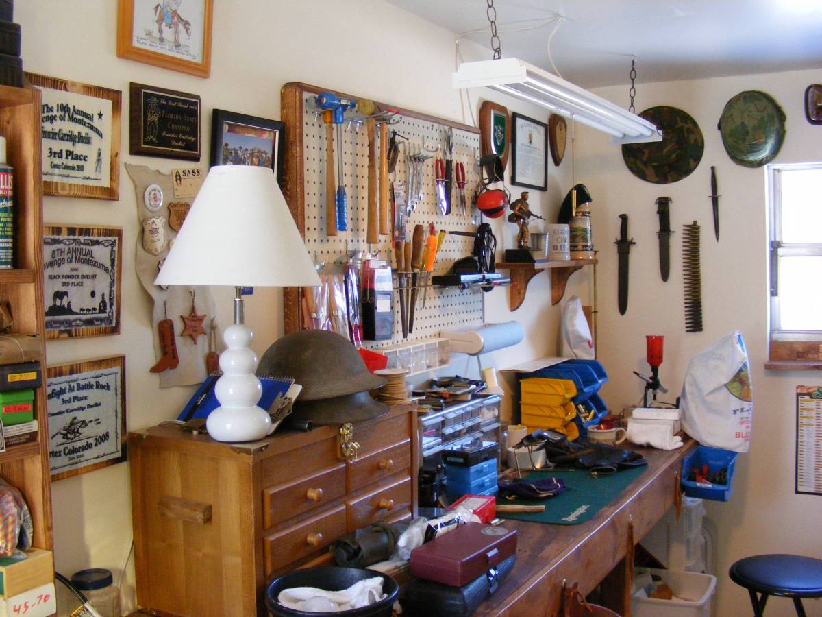

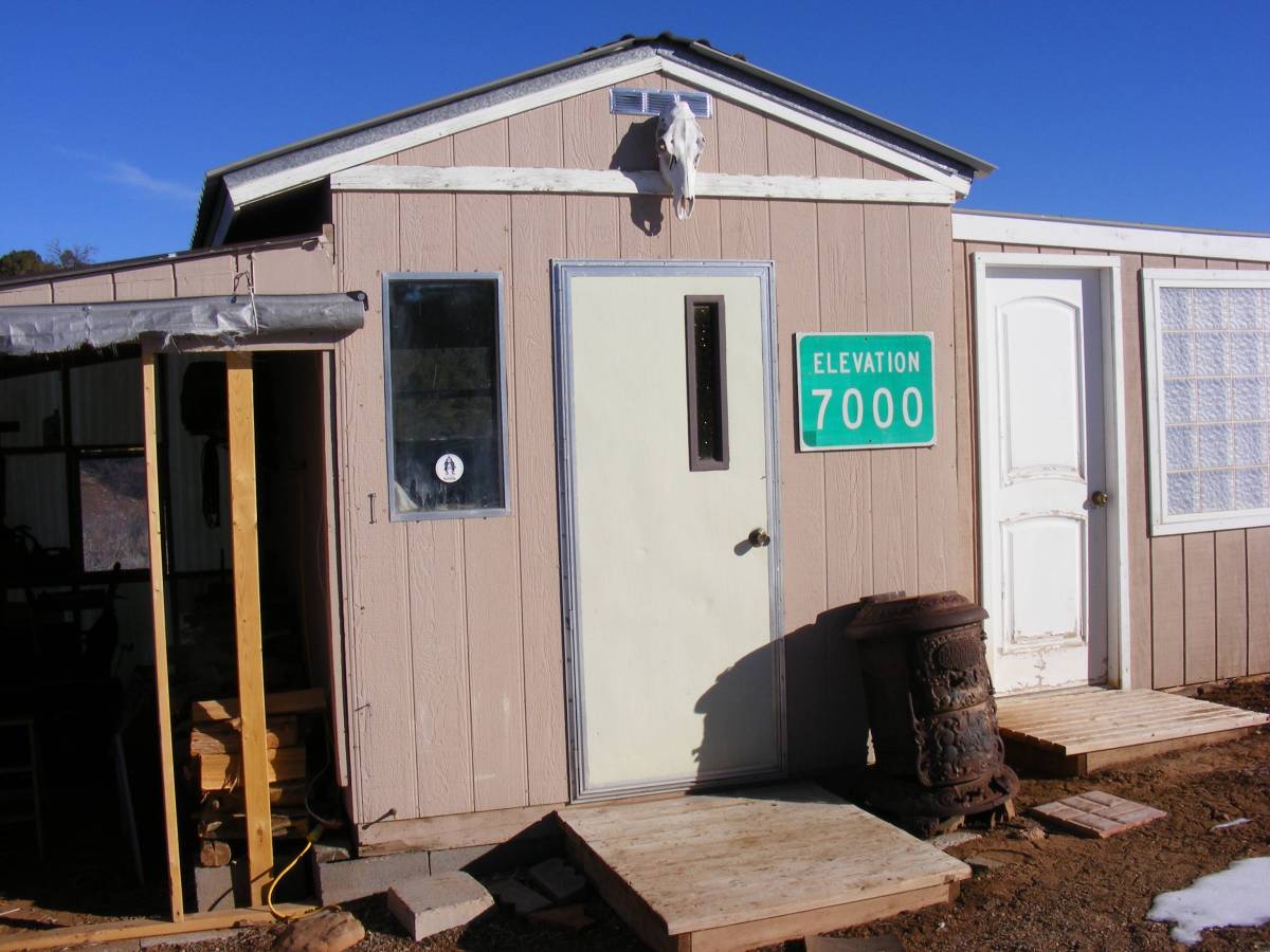

Utah Bob #35998 Posted February 4, 2011 Posted February 4, 2011 My gun room is on its way. I would like to know what do you have in your gun rooms other than loading stuff? TV, Pictures, etc. If you have any pictures of your room that would be great. Thanks Man Cave Pic 1 Pic 2 PIc 3 Pic 4
shenny Posted February 4, 2011 Posted February 4, 2011 Utah Bob is that picture of the outside of your loading room accurate today. NO SNOW? Now back to my poor excuse of a loading room, my bed room. 32" Vizeo tv, cat sleeping in my top dresser drawer, watch tv, commercial comes on stop & play with cat on way to loading bench & load 10 rounds while commercial on. Head back to the bed and wait for next commercial. Another 10 rounds, load at least 50 rounds this way some nights. Lots of commercials get more cat play than others. I won't do that Sunday night, those commericals are meant to be watched. Will load while game on. Okay, who's gonna be the first to tell me I been doing it all wrong and not blown the house up in 35 years. Shenny
Utah Bob #35998 Posted February 4, 2011 Posted February 4, 2011 Utah Bob is that picture of the outside of your loading room accurate today. NO SNOW? Shenny Yup. Except for drifts, there is only about 3" on the ground right now and it's 37 degrees. Not a bad winter so far.
