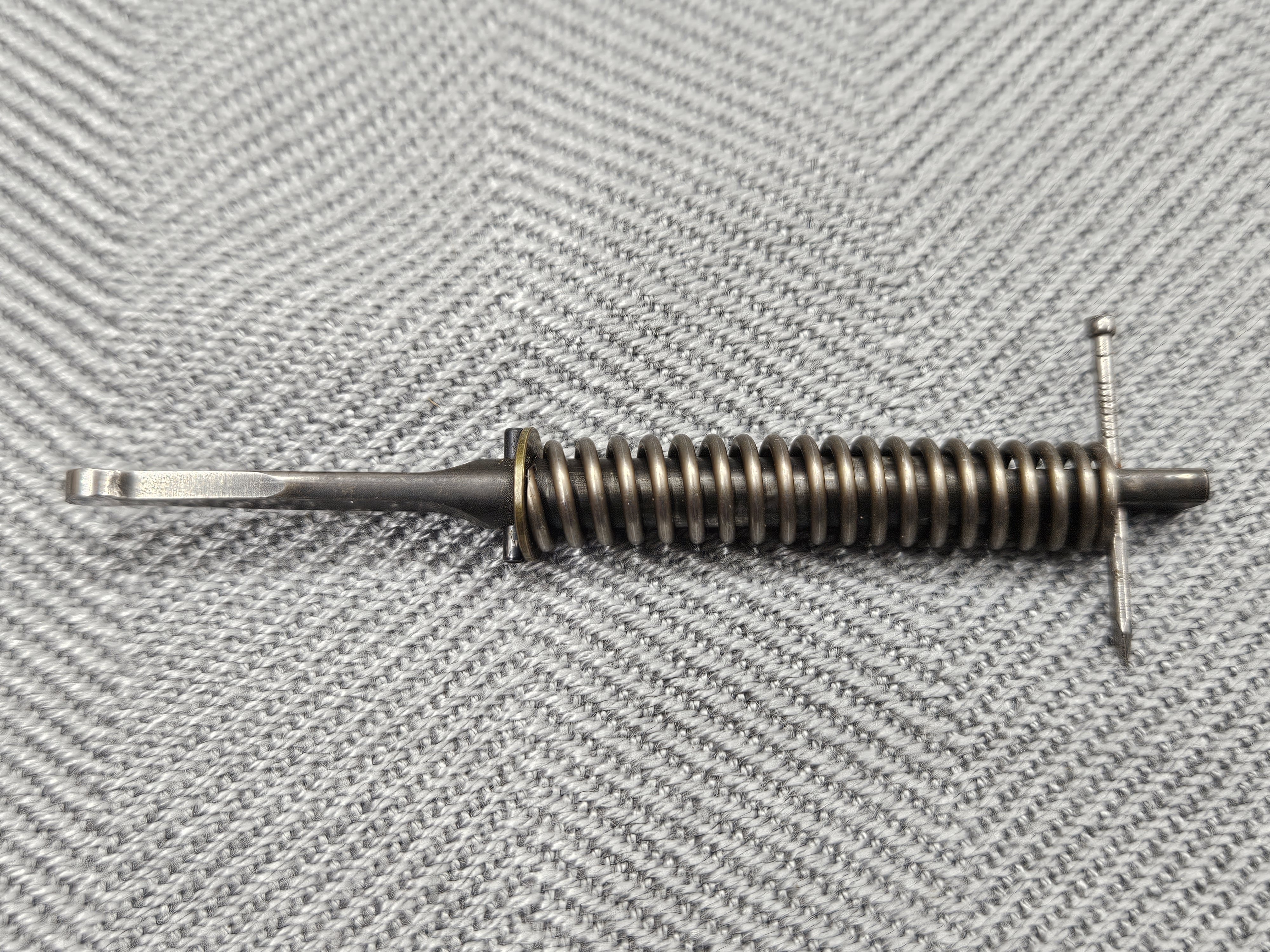

Have never seen the top screw in the bolt version.
What was it's purpose?

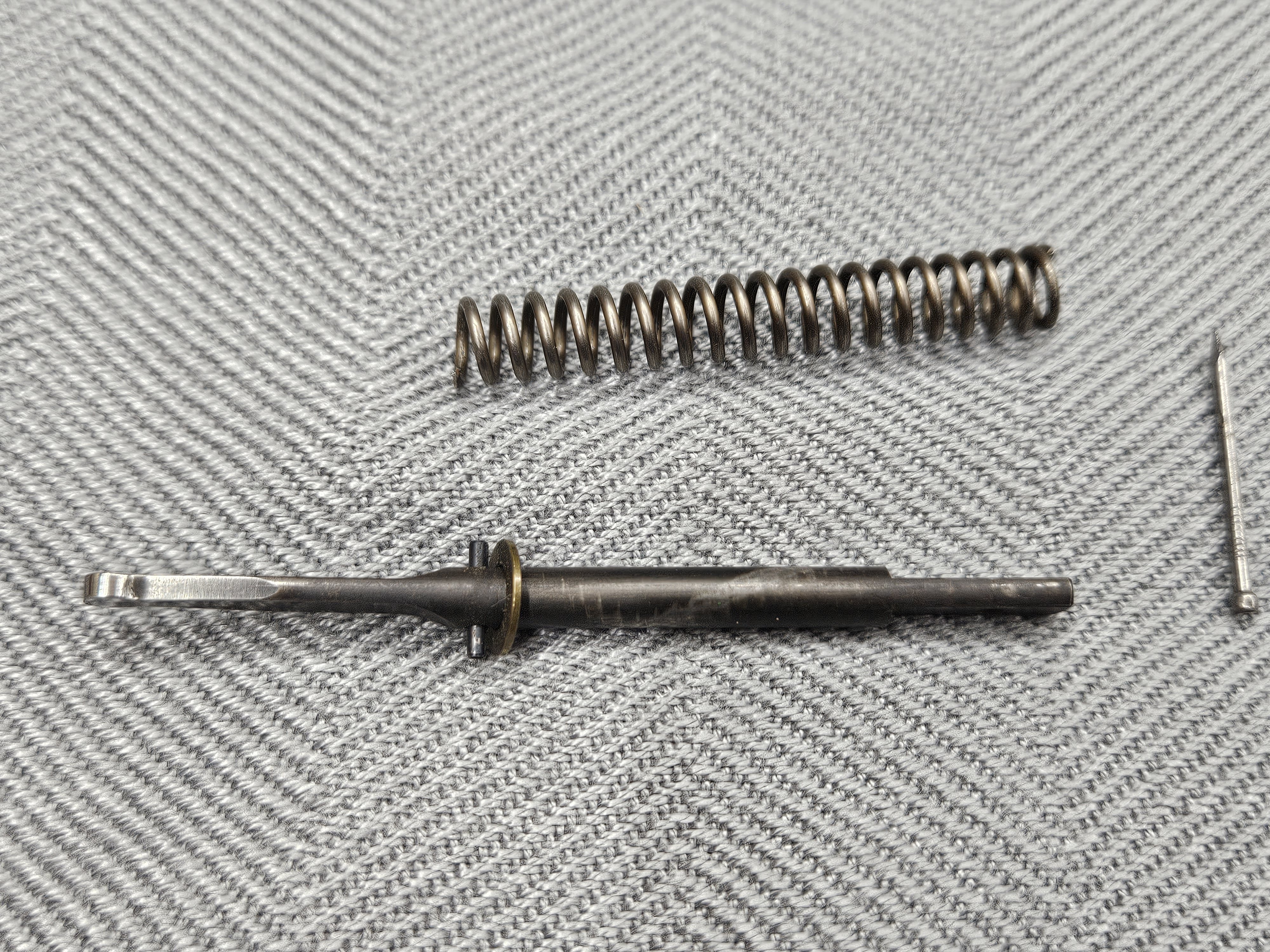

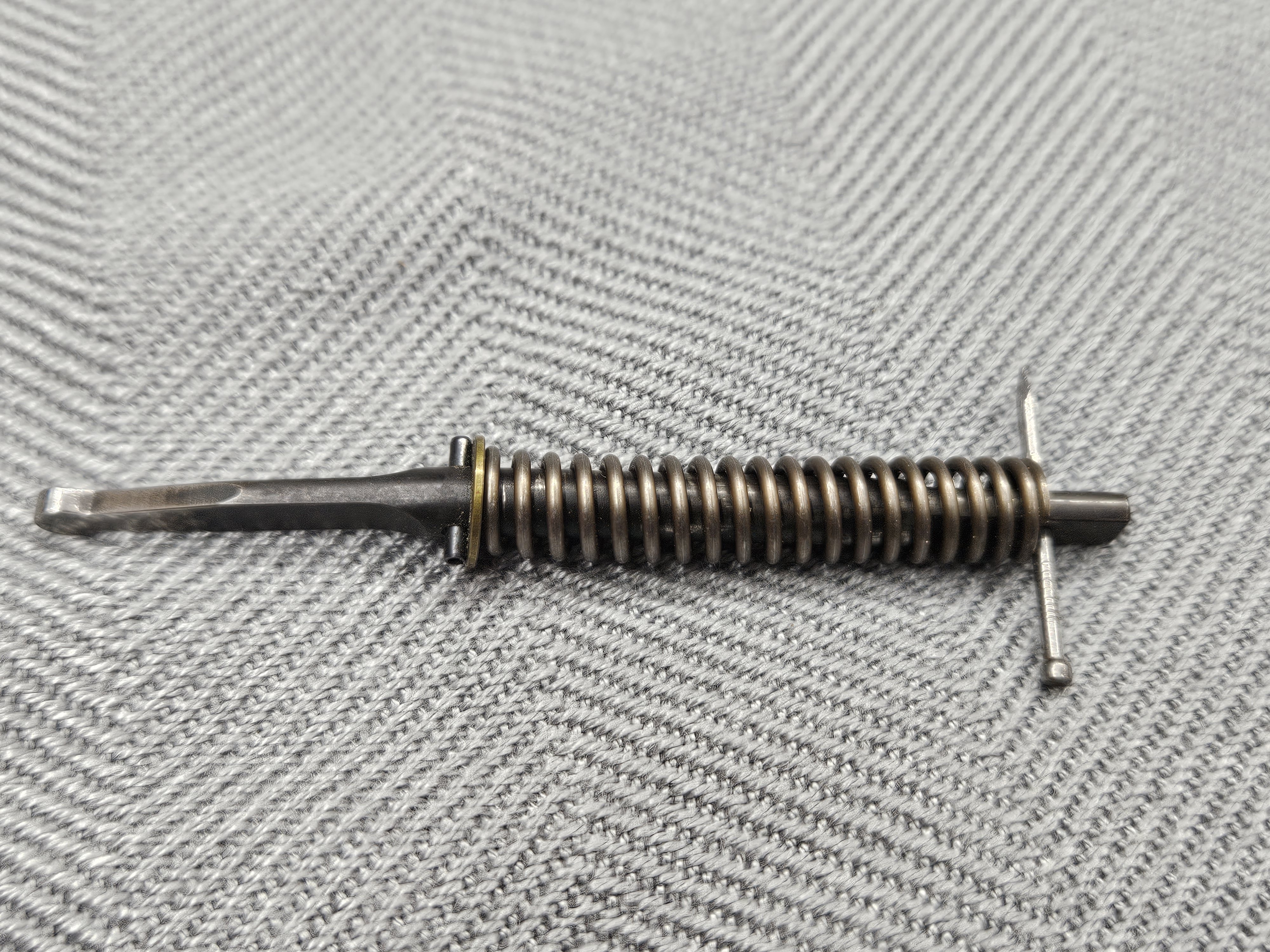

There are at least three types of firing pins. The very early(a couple thousand) guns used a different firing pin than the majority. That screw retains it. There is no cross pin like later guns/ repro's. 1901's used a firing pin retraction lever, so those firing pins are different. That is also a feature that didn't make it into any repro's.
