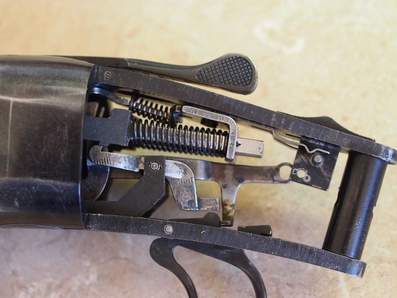

Winchester Model 24 SxS
Larsen E. Pettifogger, SASS #32933 replied to Hawkeye Kid's topic in SASS Wire
Yes and sort of. The 24 was built by Winchester when there still was a Winchester. American built of quality materials. It is large and somewhat ungainly. It is, however, striker fired and the trigger pulls feel like a quality rifle trigger. I have a large collection of takedown manuals and books but have never found take down instructions for the Model 24. All you can find on-line are schematics. The only thing I found in searching the Internet was a thread on a website where someone cautioned against removing a large screw on top of the receiver that appears somewhat like a stock screw. The reason being if you remove that screw the internal mechanism falls into the action. With that caution I did remove the stock and spend many hours playing with the striker mechanism. The problem for SASS is that virtually no one has any experience working on them. They can be set-up to work well but finding someone that can do it is pretty much impossible. (Photo, no hammers. The one in the photo was made in 1936.) -
