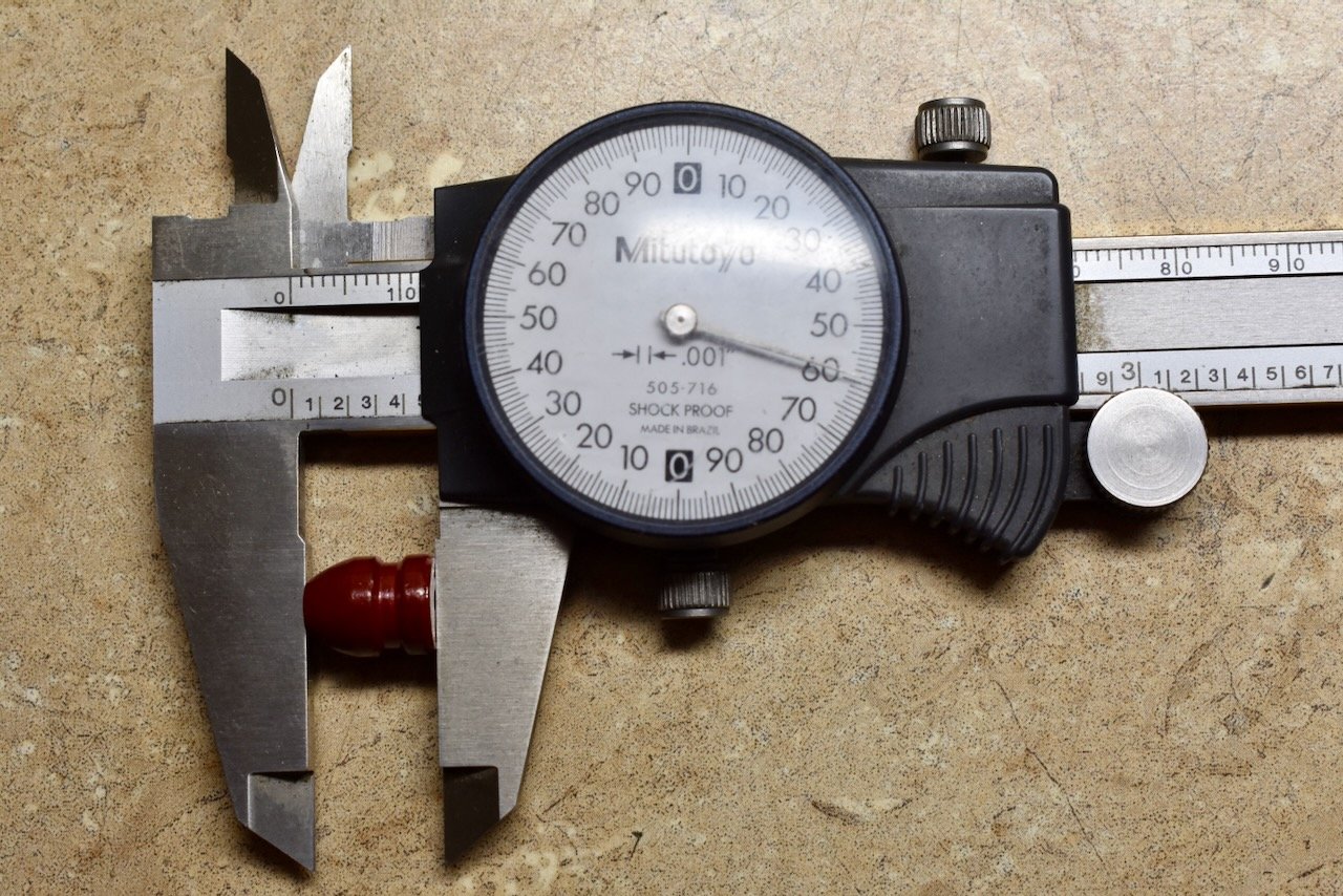

With a smile on my face and love in my heart let me ask you a question. Did you ask or did you do what I do which is look and if I can't find it I give up. There are five ACE's within a few miles of my house. They all have a section in their specialty fasteners section that have gun screws. HOWEVER, this is a grip screw. It does not have to be a "gun" screw. It can be any screw except nylon/plastic or maybe aluminum. Here is a photo of one of a 25 year old pair of Eagle Buffalo Horn grips. (I screwed the screw out so it can be seen better.) The screws are brass. -

This is the specs for the Brownell's screw set. Note the thread size. Will not work with Ruger. I already suggested where to find cheap 6-40 screws. Specifications: Material: 18-8 stainless steel screw; brass nut Thread Size: 5-40 Screw Length: 1-3/8 inches (3.5 cm) Package Options: Available in packs of 6 or 12 -

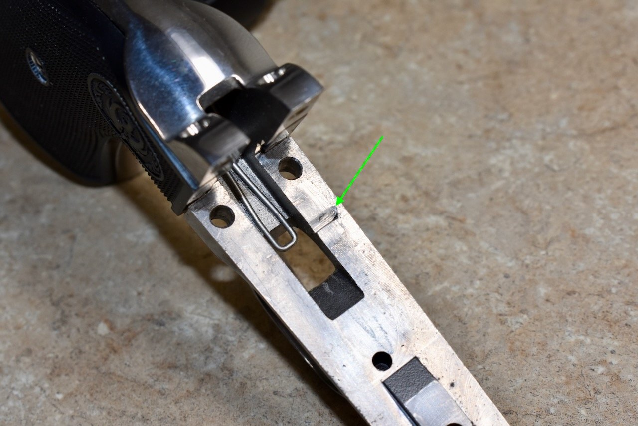

Big Frickin Hammer. No it should not be rubbing or necessarily that tight. To fix the immediate problem hit the pin on the side with the red and eyeball it until it is in the middle of the bolt. -

Punch and BFH. -
