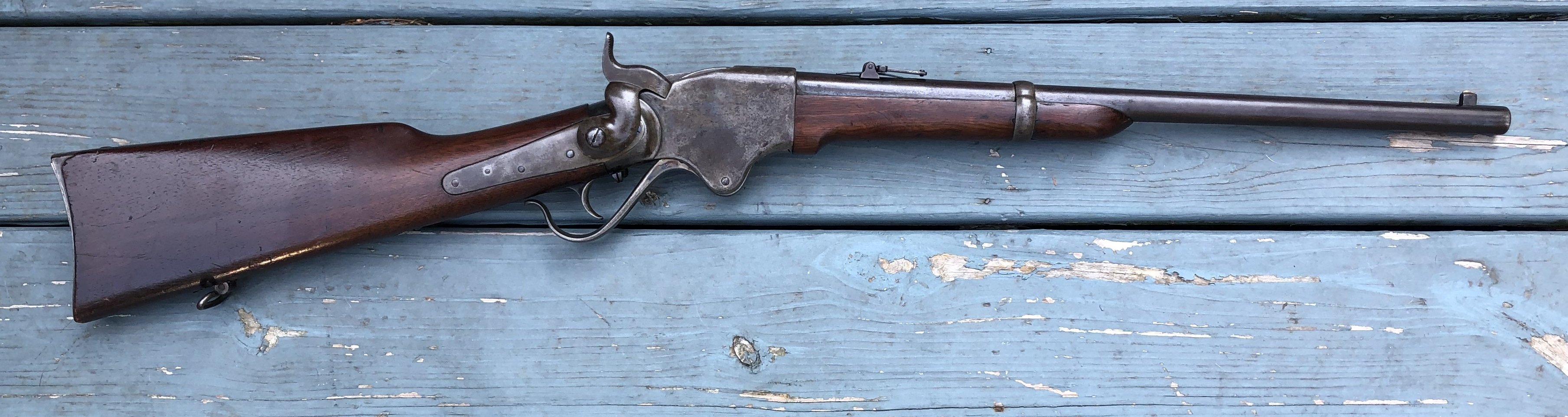

.56 or .50 caliber? Unlike other early cartridge naming conventions, with the Spencer, 56-50 and 56-56 it is the SECOND number that denotes the caliber of the bullet, not the first. I have read that the only difference is the amount of crimp it takes to hold the bullet, that they both actually use the same brass. If it's an 1860, there's a good chance it's a 56-56, so plan to reload accordingly, Best to have the barrel slugged to be sure. BTW... A fine old veteran. When I do shoot it, I pair it with a Rogers and Spencer revolver converted to .45 Colt, and 1860 converted to the the same caliber. I'd love to also pair it with a Spencer shotgun, but they ain't SASS Legal, and I don't own one anyway.
First you need to know that the modern replicas and originals use different sized brass. Original brass will not fit in a repro and repro brass will not reliably eject. Something about rim size. The only place I know to get brass for an original is Buffalo Arms and yes it is expensive. That said owning and shooting a genuine Civil War surplus rifle is a huge amount of fun. After shooting the 7 in the magazine, I load the last three directly into the chamber. Which model is yours? Some eject spent brass better than others. Mine's a model 1865 Bannerman with the triangle blade ejector. It often only pulls the spent round halfway out of the chamber and I have to flick it away by hand. In other words, shooting a real Spencer is a slow, quirky process. But once you get the hang of it, it is a lot of fun. Good luck!

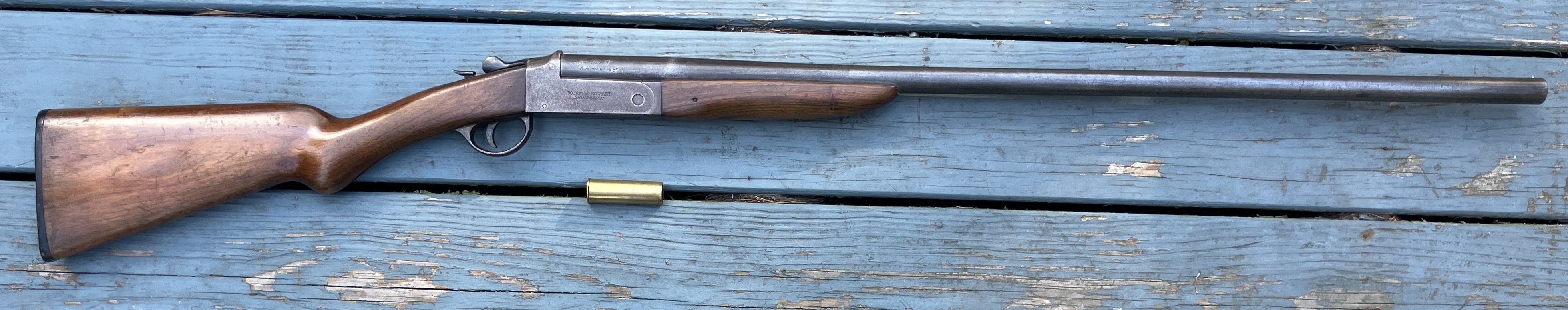

Fascinating! The firing pin on my Greener was also busted. Best way I can describe it is to say that the tip of the pin broke off, and the pin was at that perfectly strange length were sometimes it would go bang and sometimes it would just go click. He made a new firing pin for it, and now it works just fine.

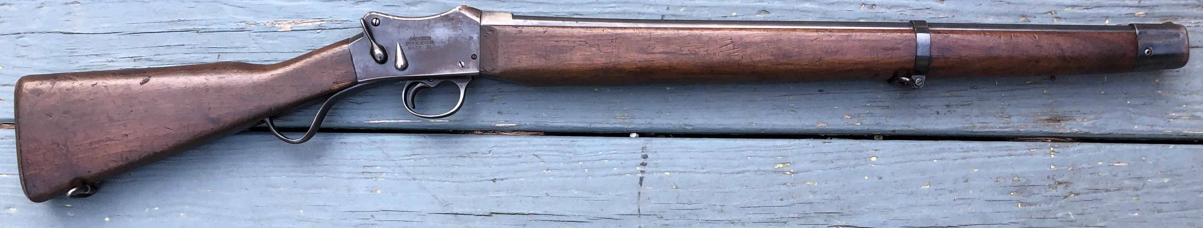

Very cool, Watab. Yours looks to be in quite excellent condition. It seems like EVERY major gun maker in England made things based on that Martini action at one time or another. You could probably build quite a collection just by trying to get an example from manufacturers alone! My above shotgun is a Greener, but my .303 is an Enfield, and my Cadet Rifle is BSA. Don't have a .22 yet, or one of the "big bore" ones for the Boer War era, but the more I research the Martini, I just find more people who made them. But, anyway, I assume yours is a 12 gauge? How do you find it to be as a shooter? On another note, I did some research and came across the names of Westley-Richards and Rigby as gun makers that are still in business over there. The W-R guns seem to have prices all over the map, from very affordable to very expensive. And, you can get a factory letter for them, for $270.00! And I thought Colt letters were expensive. Rigby guns on the other hand seem to all have a 5 figure price tag, and their factory letters go for 100 pounds a pop. I doubt that I'll ever have a Rigby in my collection. If I was gonna spend that kind of money, it'd be for a high grade Parker in pristine condition. But I doubt I'll ever spend that kind of money on a single gun. A W-R? Well, if the price is right and there was something about it I found interesting, I'd not rule one out, even factoring in the cost of the letter. It does seem that English guns tend to be rather expensive. Given the heavy restrictions on ownership over there, I wonder how they can stay in business.
