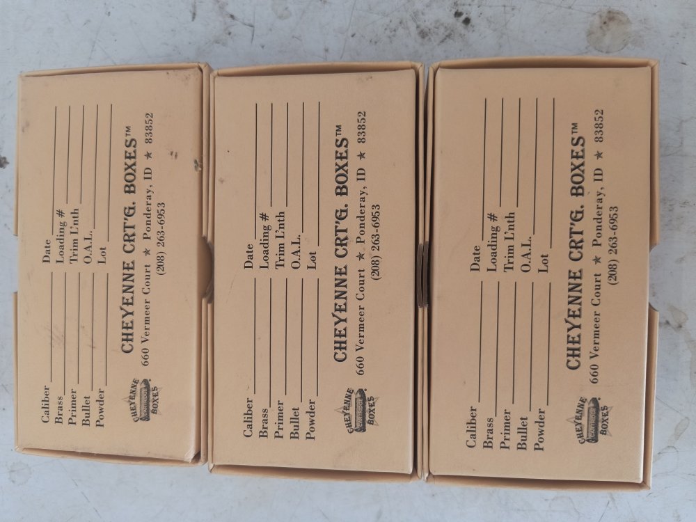

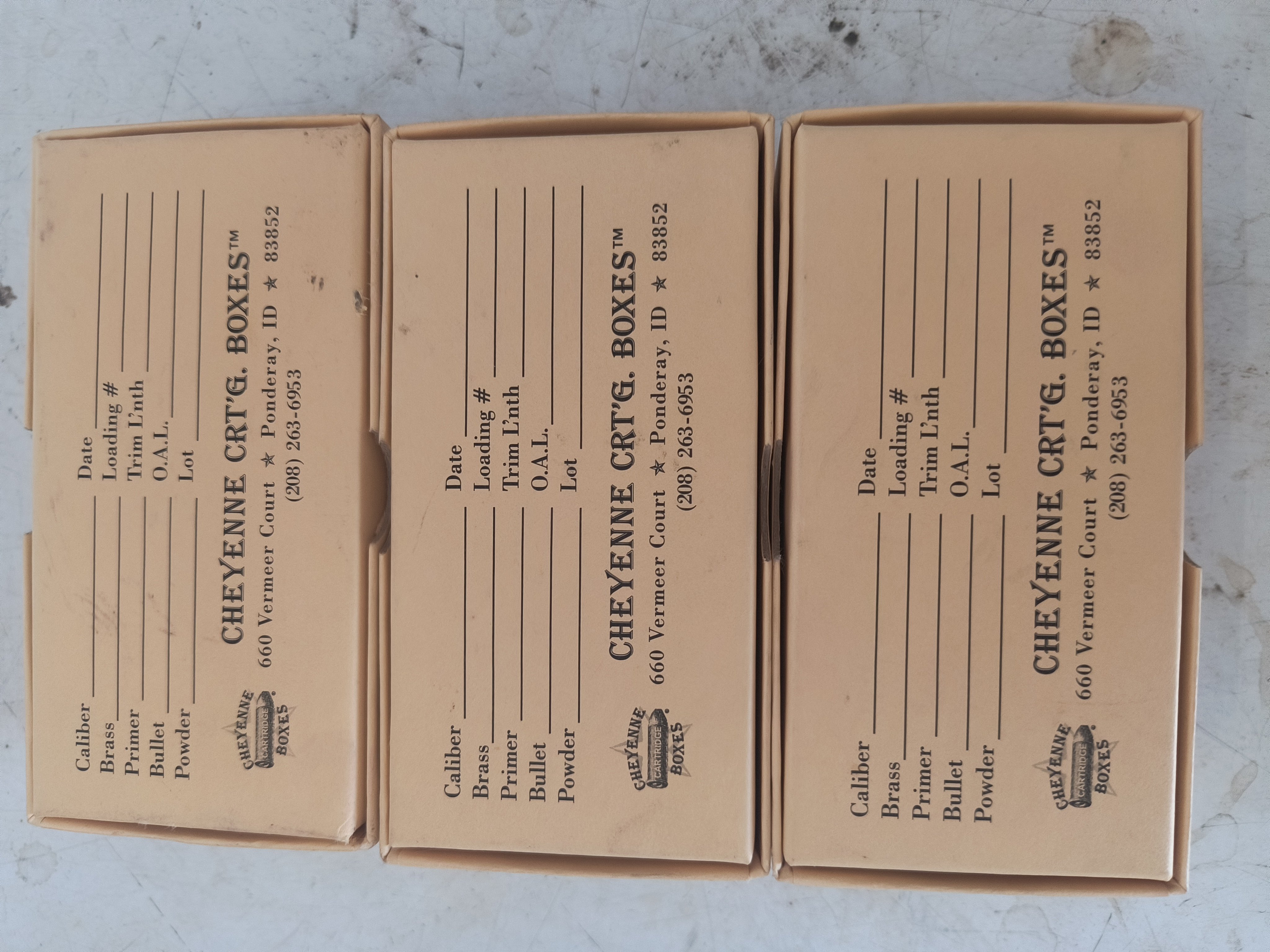

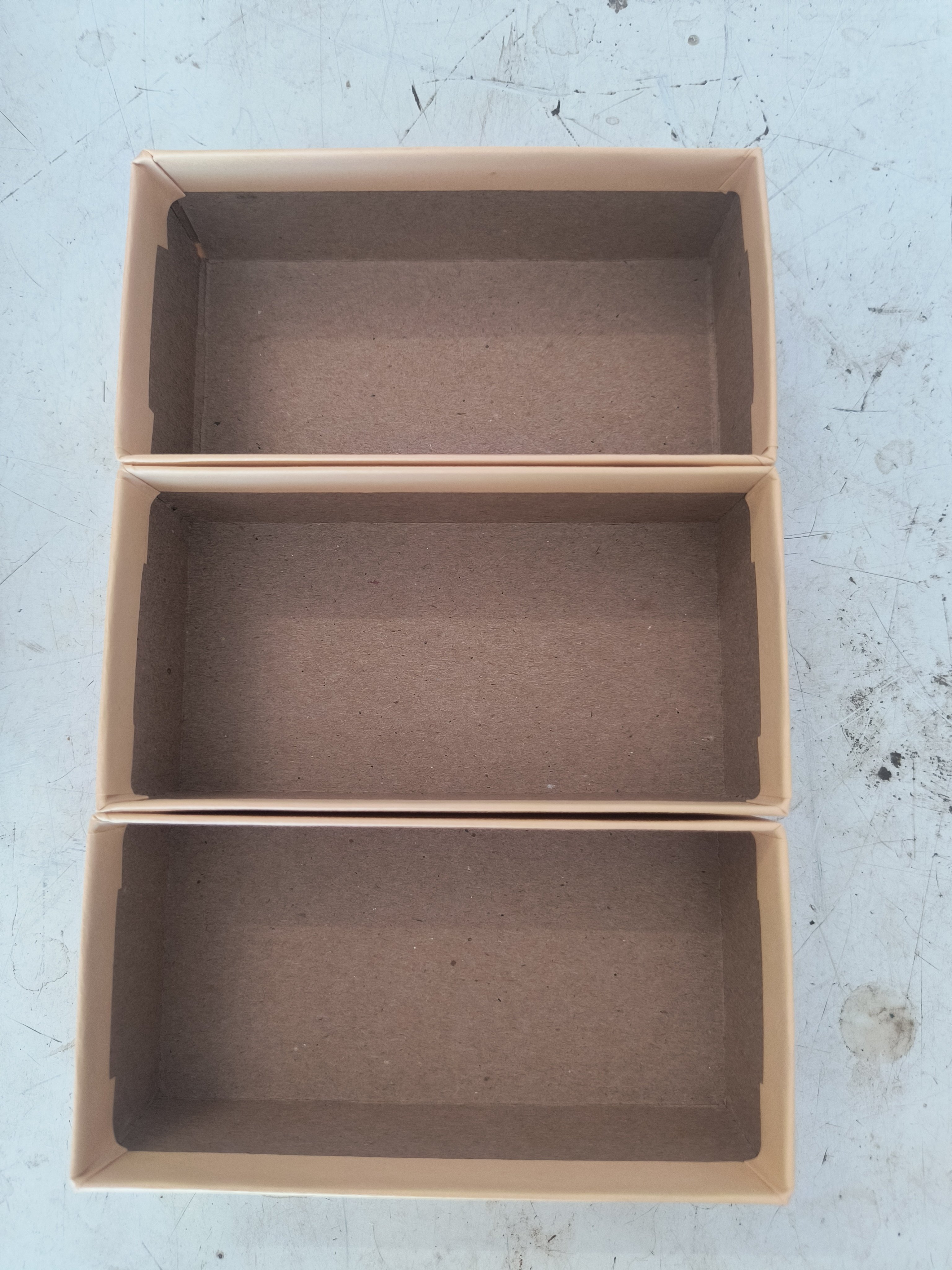

I was gifted these several years ago by a friend and unfortunately they have sat on a shelf ever since. If these fit your needs, I am willing to pass the gift forward. Maybe $10.00 for shipping? Regards, Chas B Wolfson -

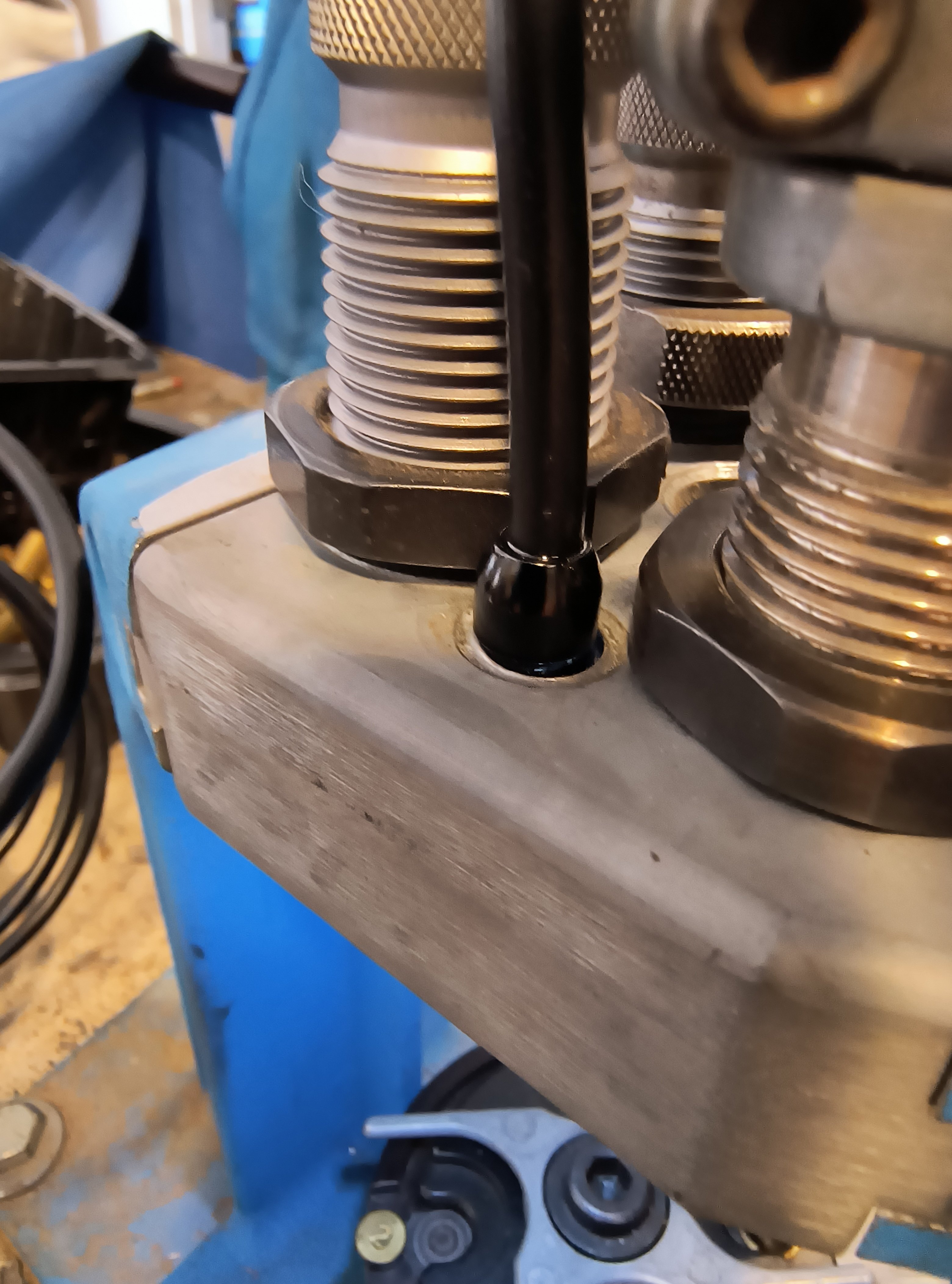

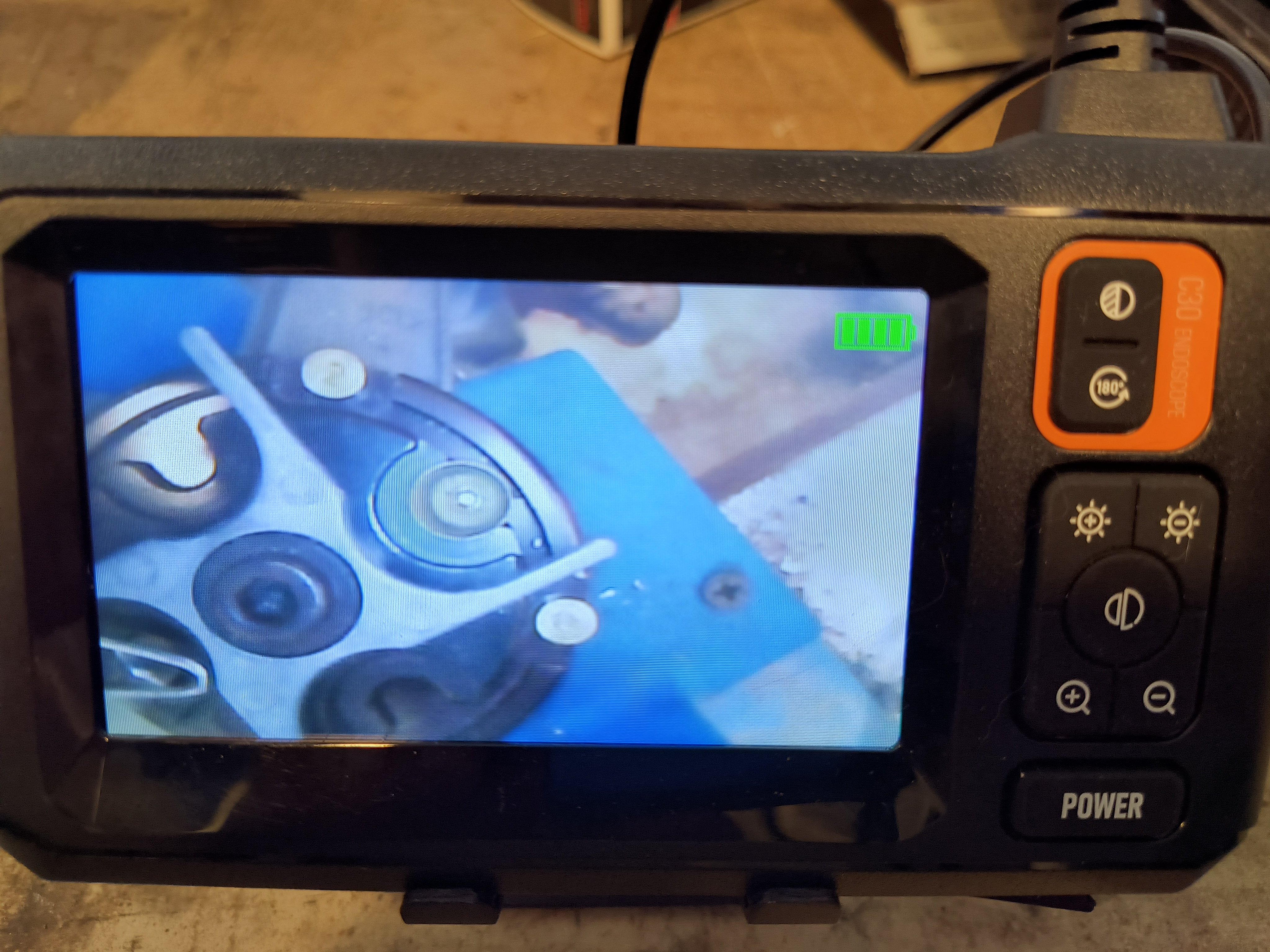

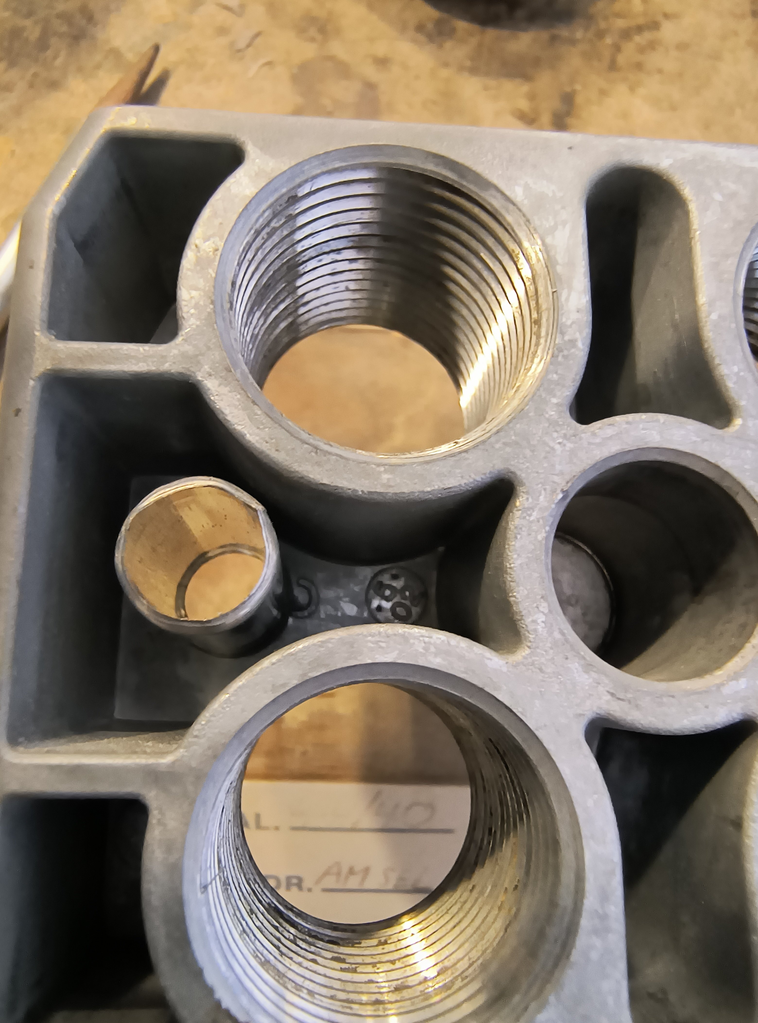

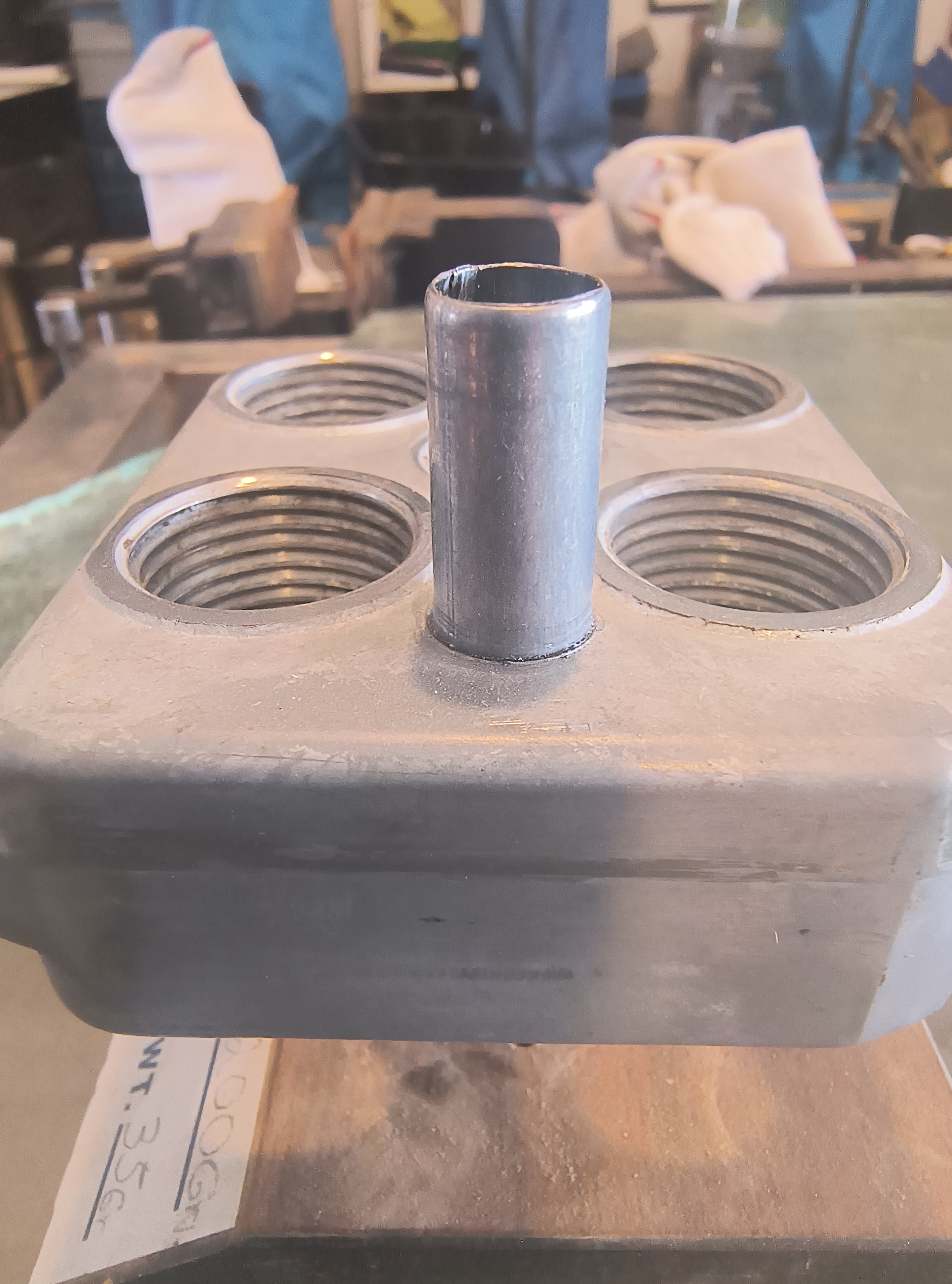

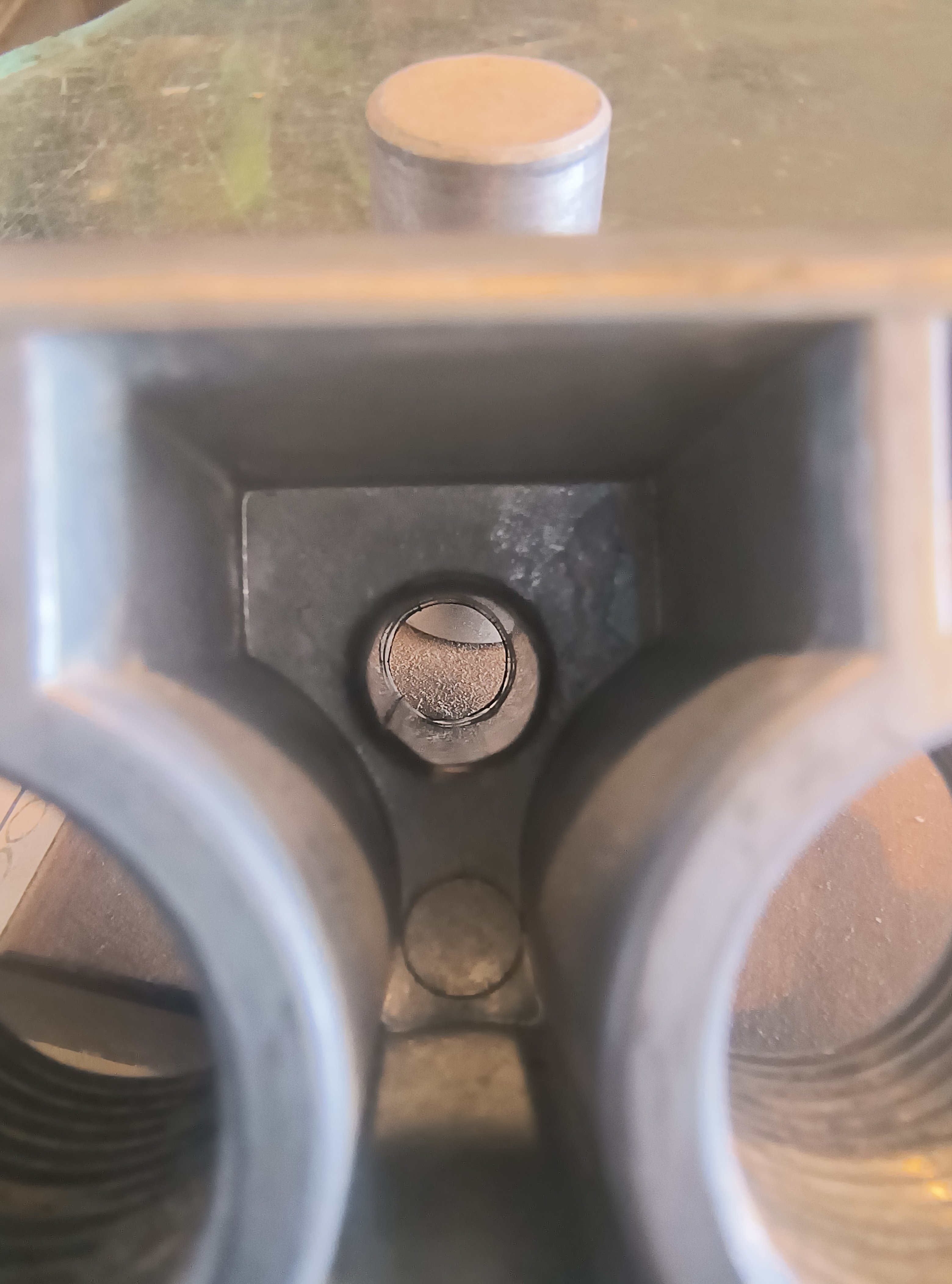

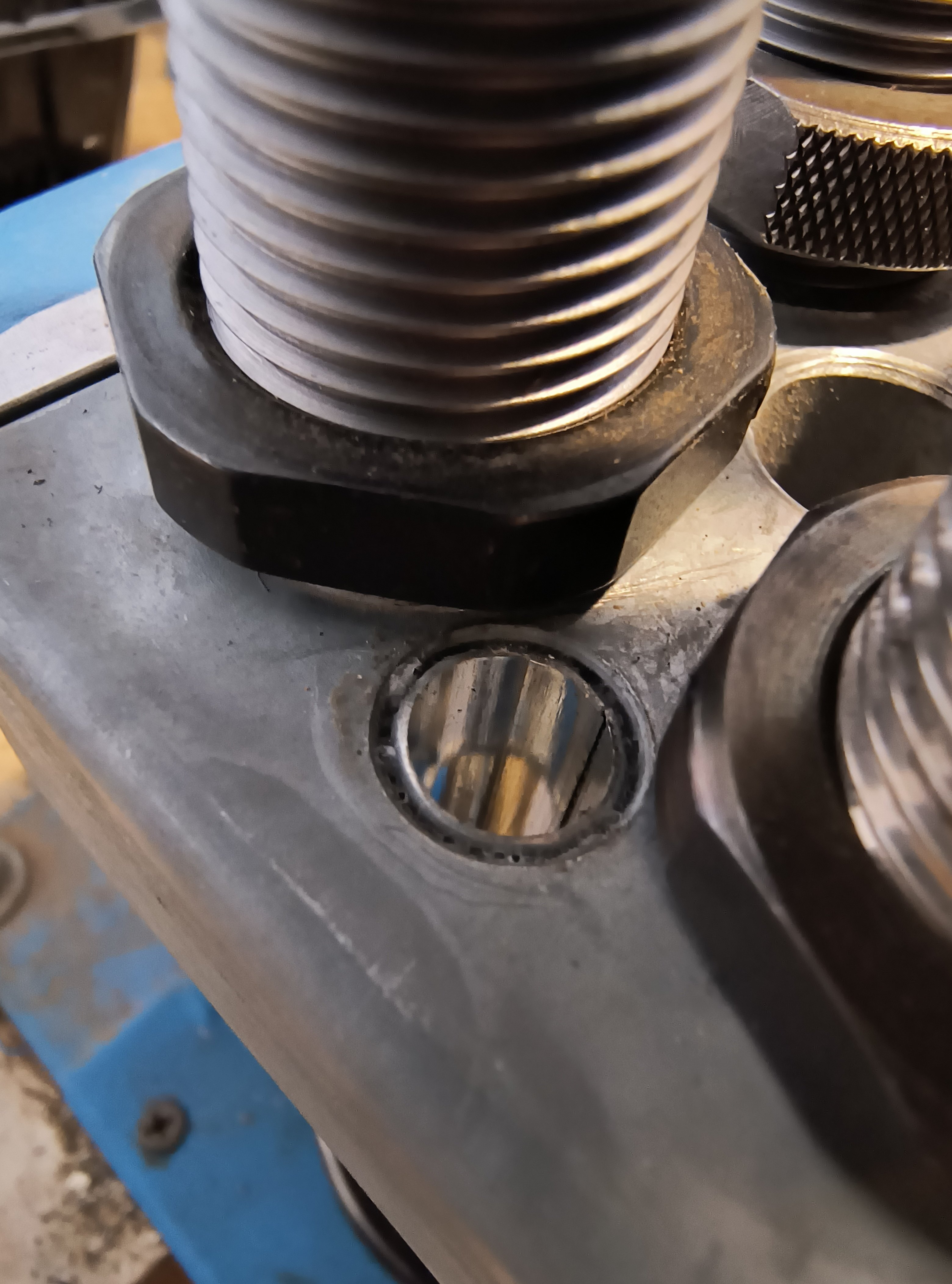

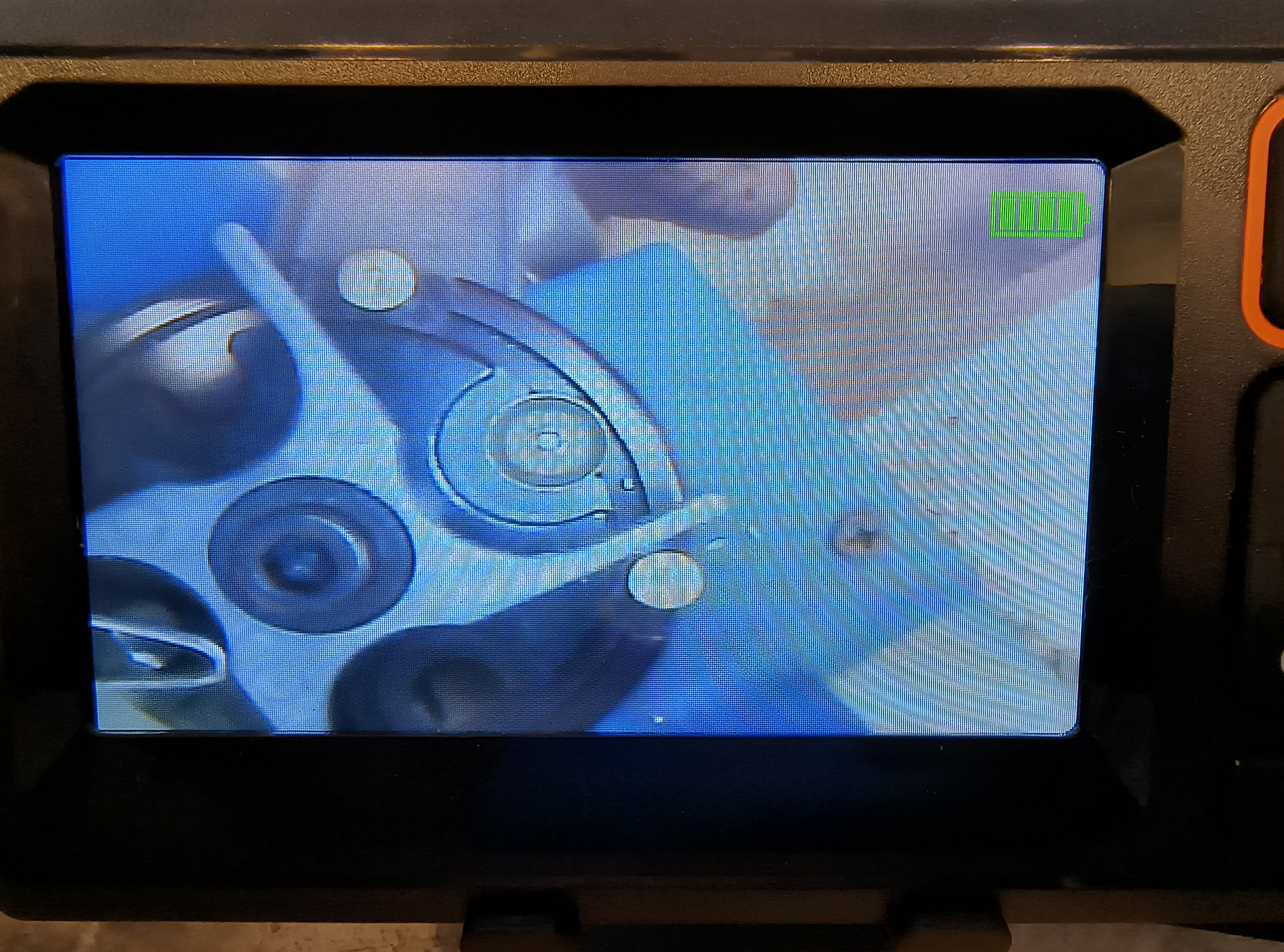

Camera setup on a 550 Dillon
Chas B. Wolfson, SASS #11104 replied to Chas B. Wolfson, SASS #11104's topic in SASS Wire
On the 650 used for rifle cartridges, I am thinking about replacing the powder check and fixture with an AT500 powder die that would allow me to secure an inner tube or modified powder funnel to hold the camera head. Never have really liked the powder check gizmo. Kind of clunky. -
Actually looked at the manual. Yea, I know. Three hours of battery life. Can be used with charger plugged in. -

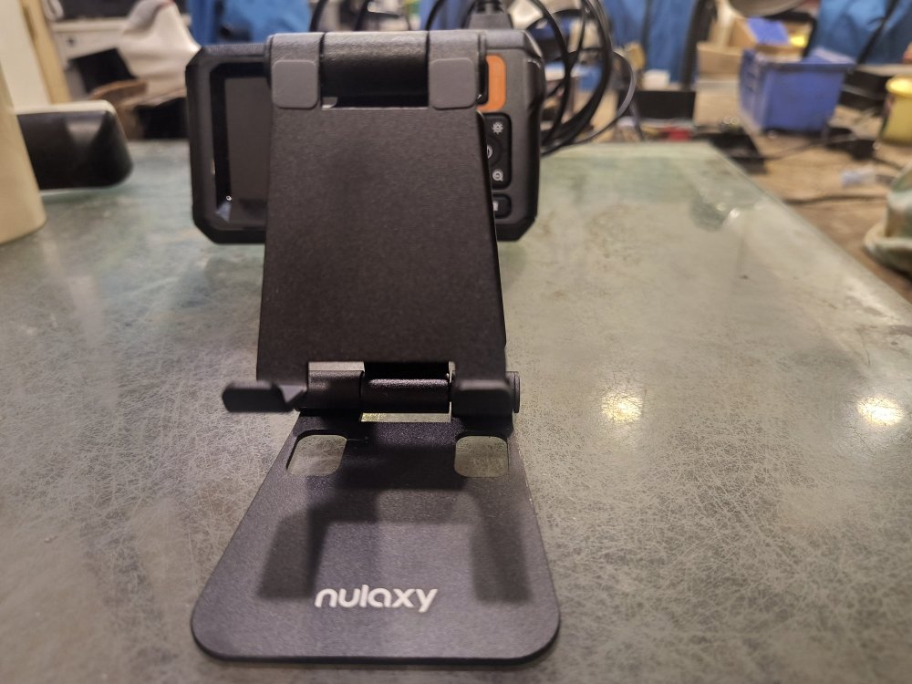

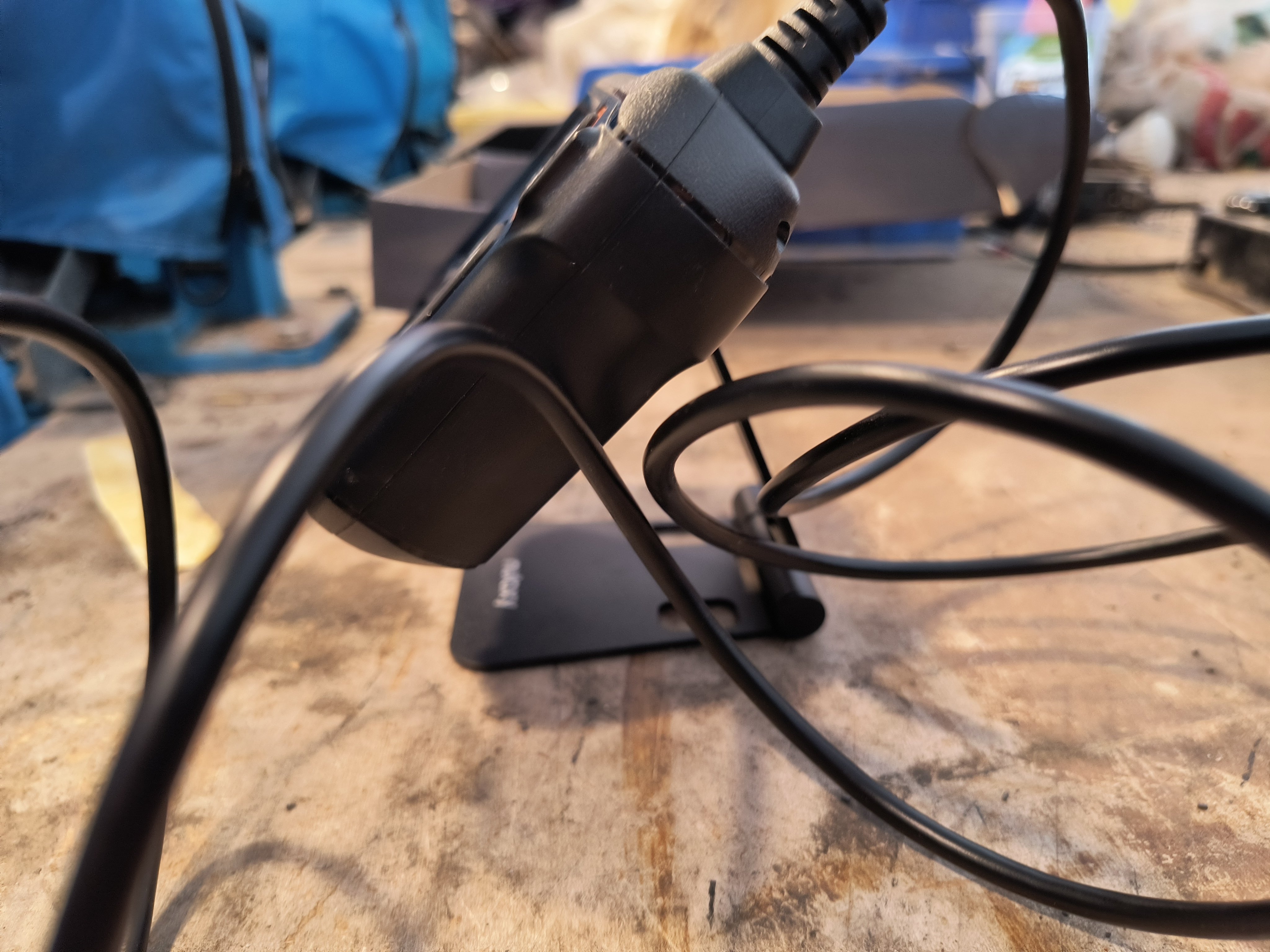

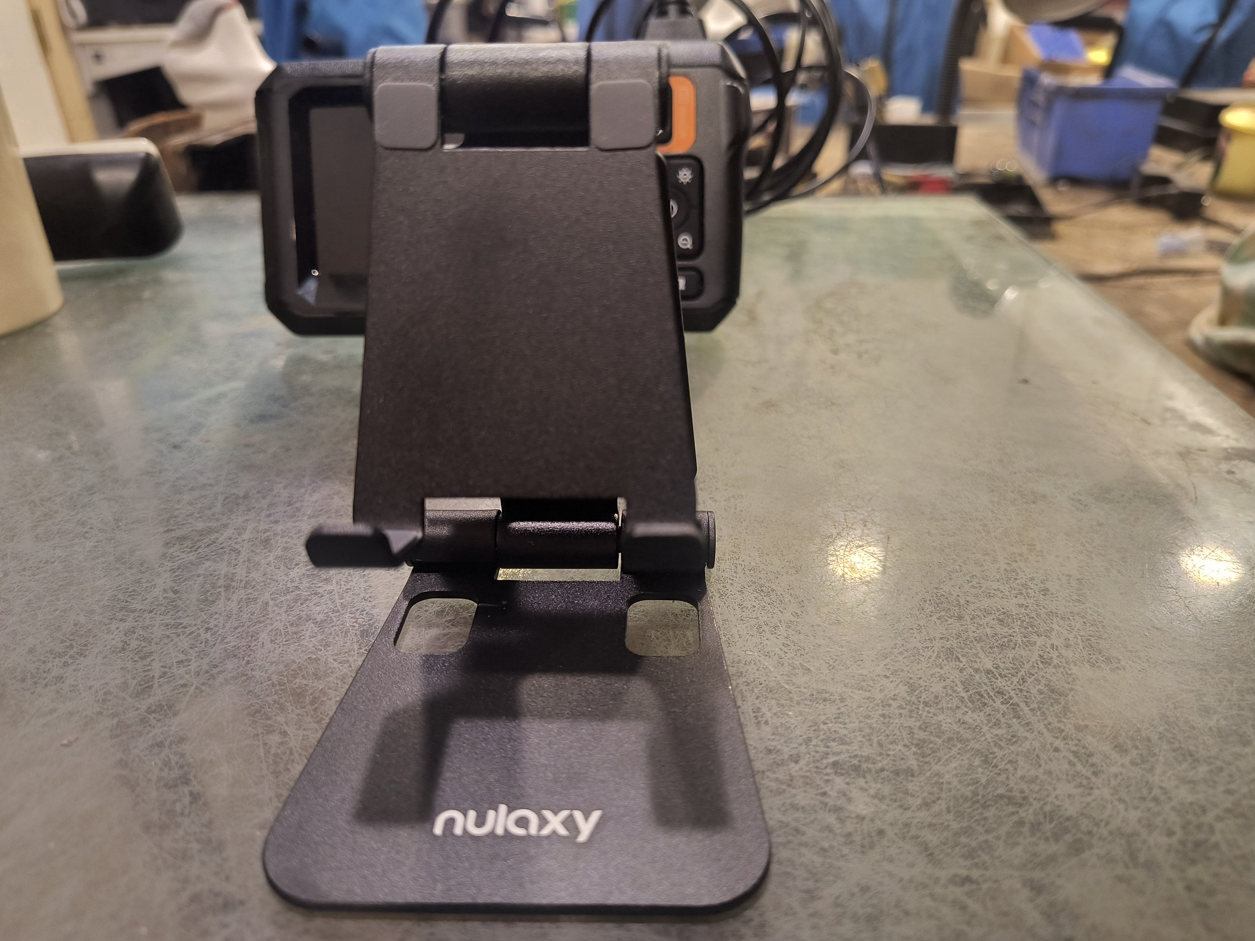

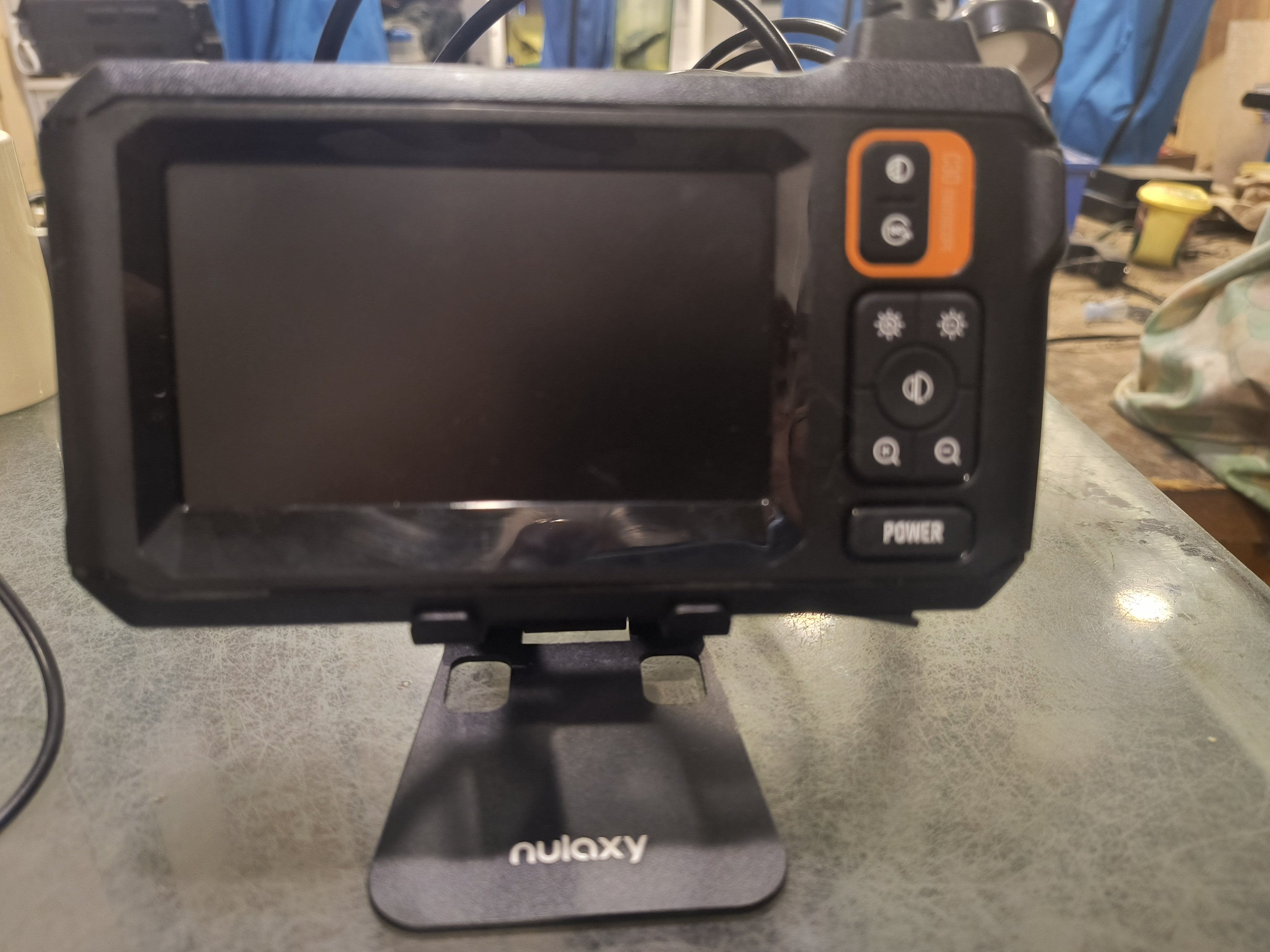

🇺🇲 I have five 550 and two 650 presses so my setup needs to be able to be moved from press to press. Cell phone holder works. Cell phone charger to run unit while using. Still a work in progress so a few tweaks still to come. -

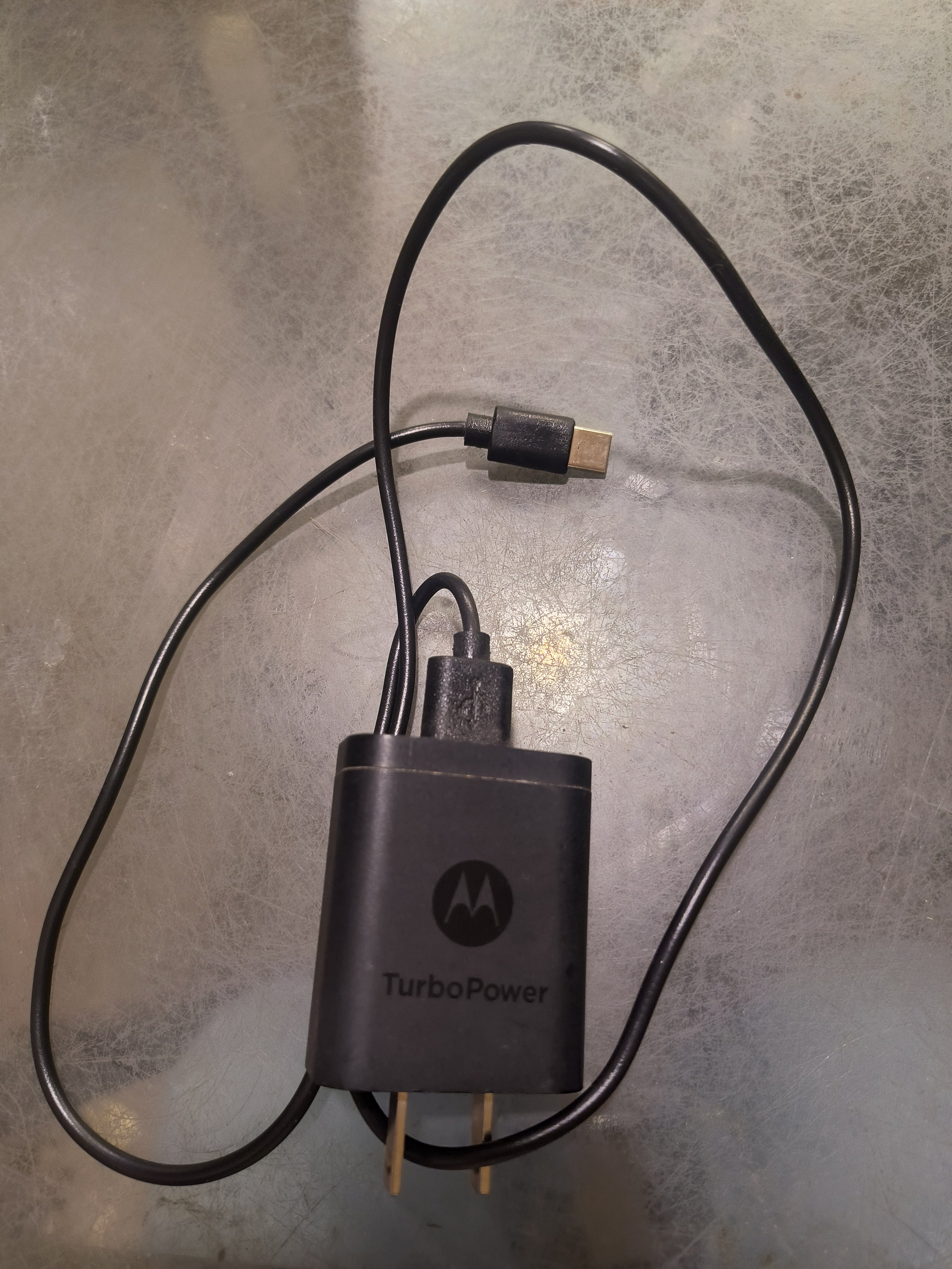

🇺🇸Not totally sure yet but after a full charge out of the box, the indicator still showed full after one hour of being left on. I plan on using a small cell phone charger to power the unit and leave it plugged into power while I use it just like my loading press light. -

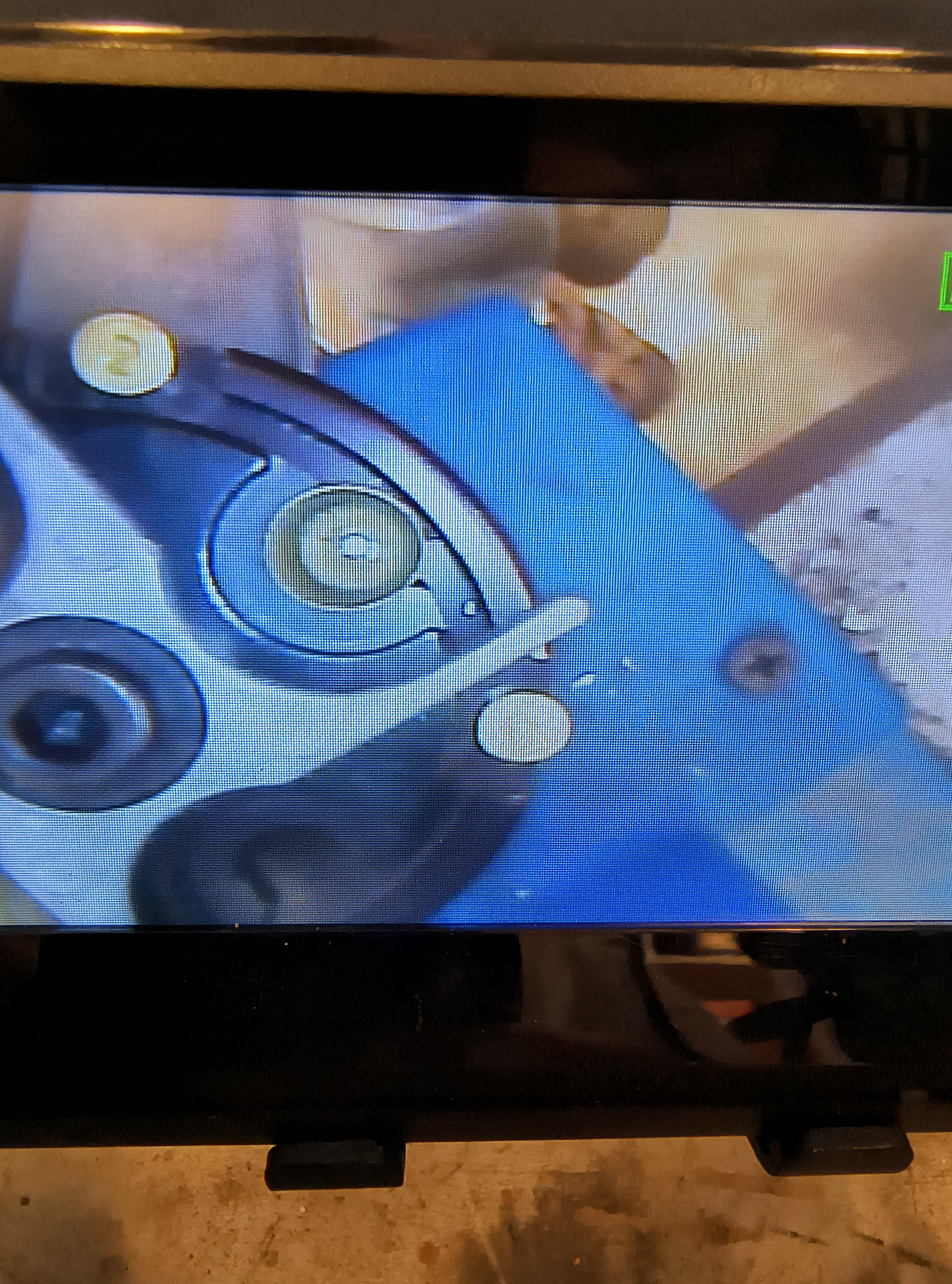

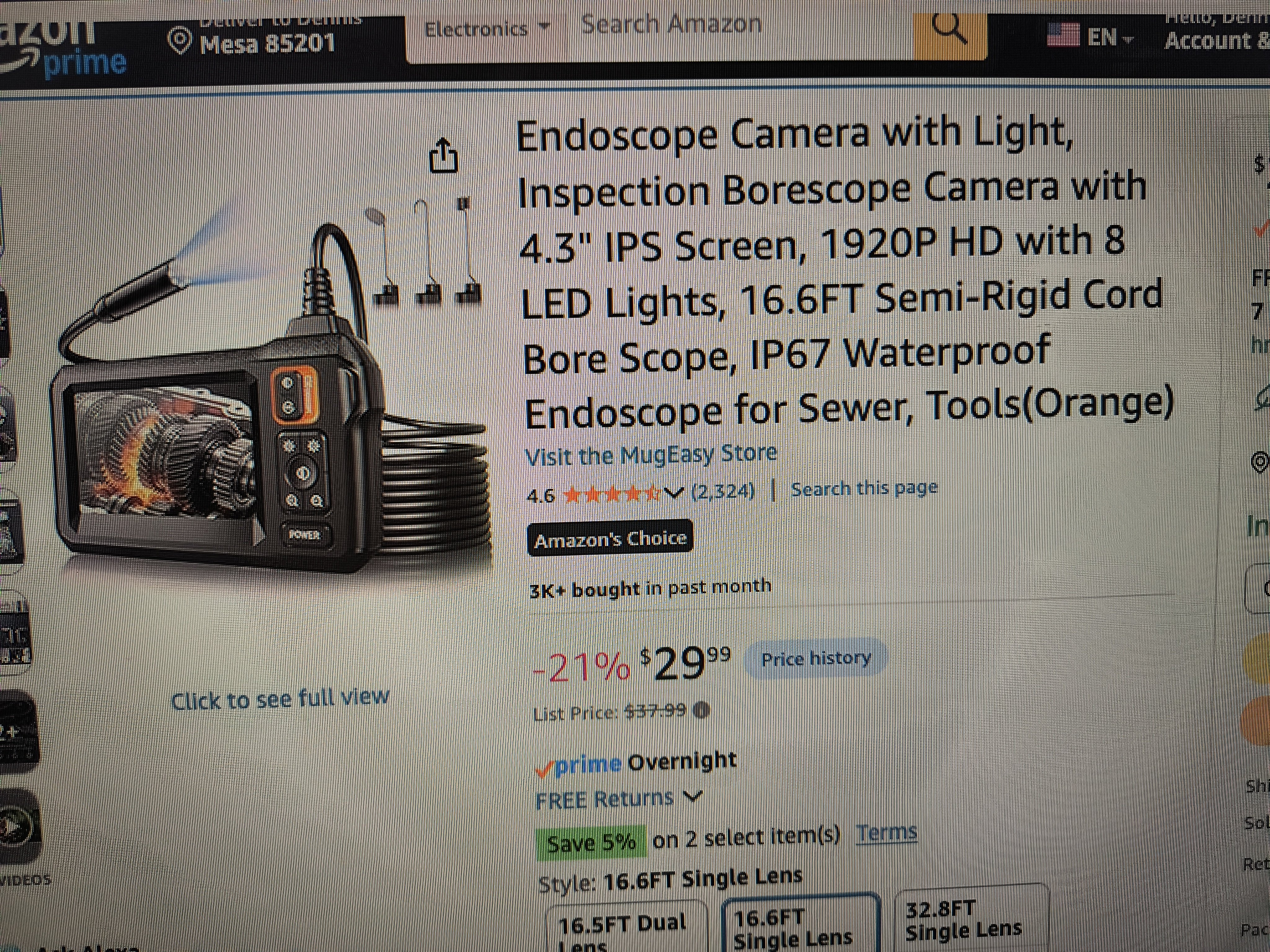

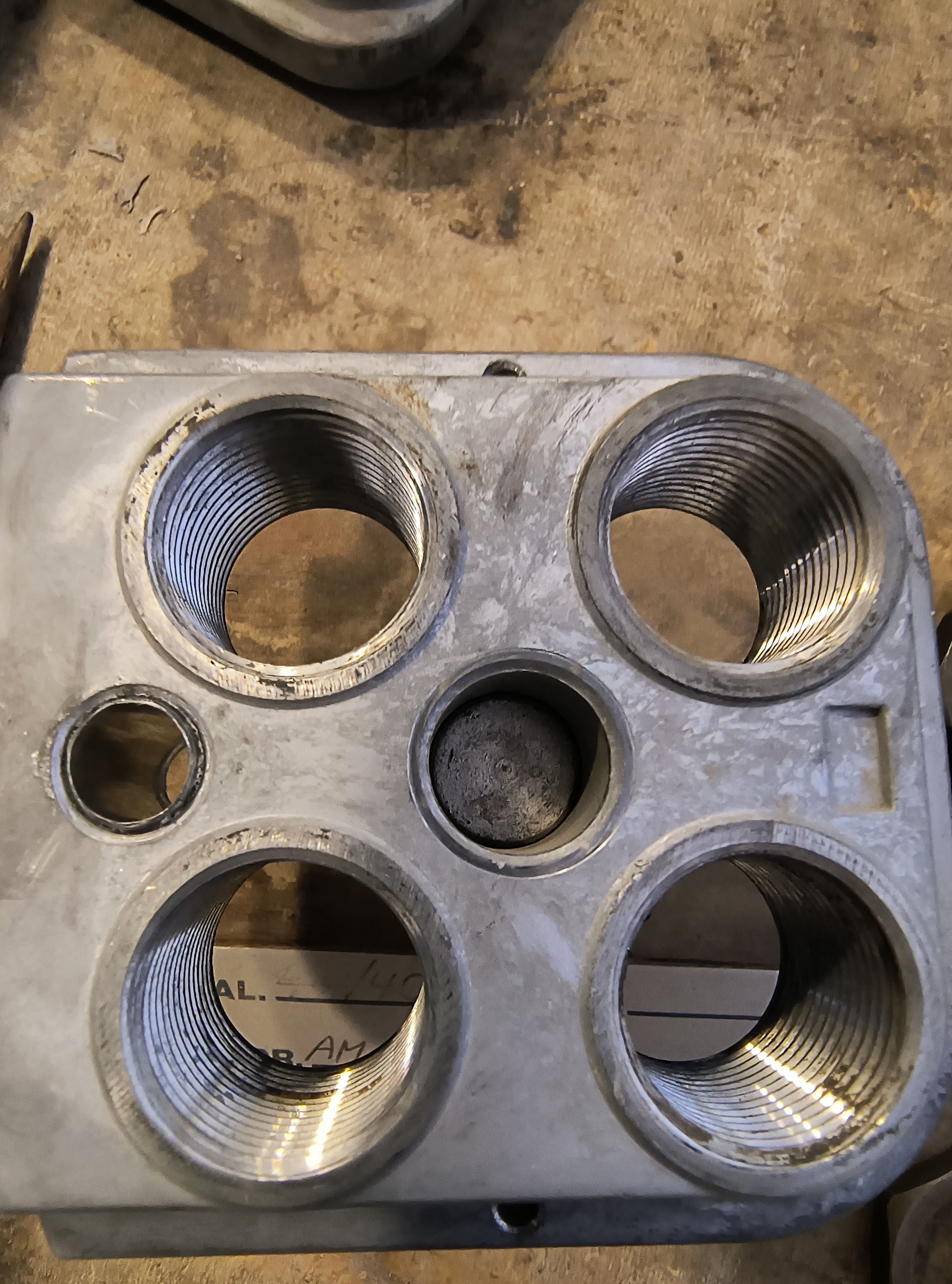

🇺🇸I know that some here consider this unneeded but I thought it would have some benefit. I used a tube laying on the shelf but a .357 case with the base cut off would do the same thing. Used super glue to hold the tube in place and rolled in the one end to keep the camera from falling through. Tube was cut at 1" using a small pipe/tubing cutter. I modified all eleven 550 tool heads I have and might do the several 650 ones as well. Bought the endoscope off of Amazon. For longer cartridges such as .556, 762X51 and 30:06, I extended the tube up out of the tool head to provide better focal clarity. Personally think the end result was worth the effort. Regards, Chas B
