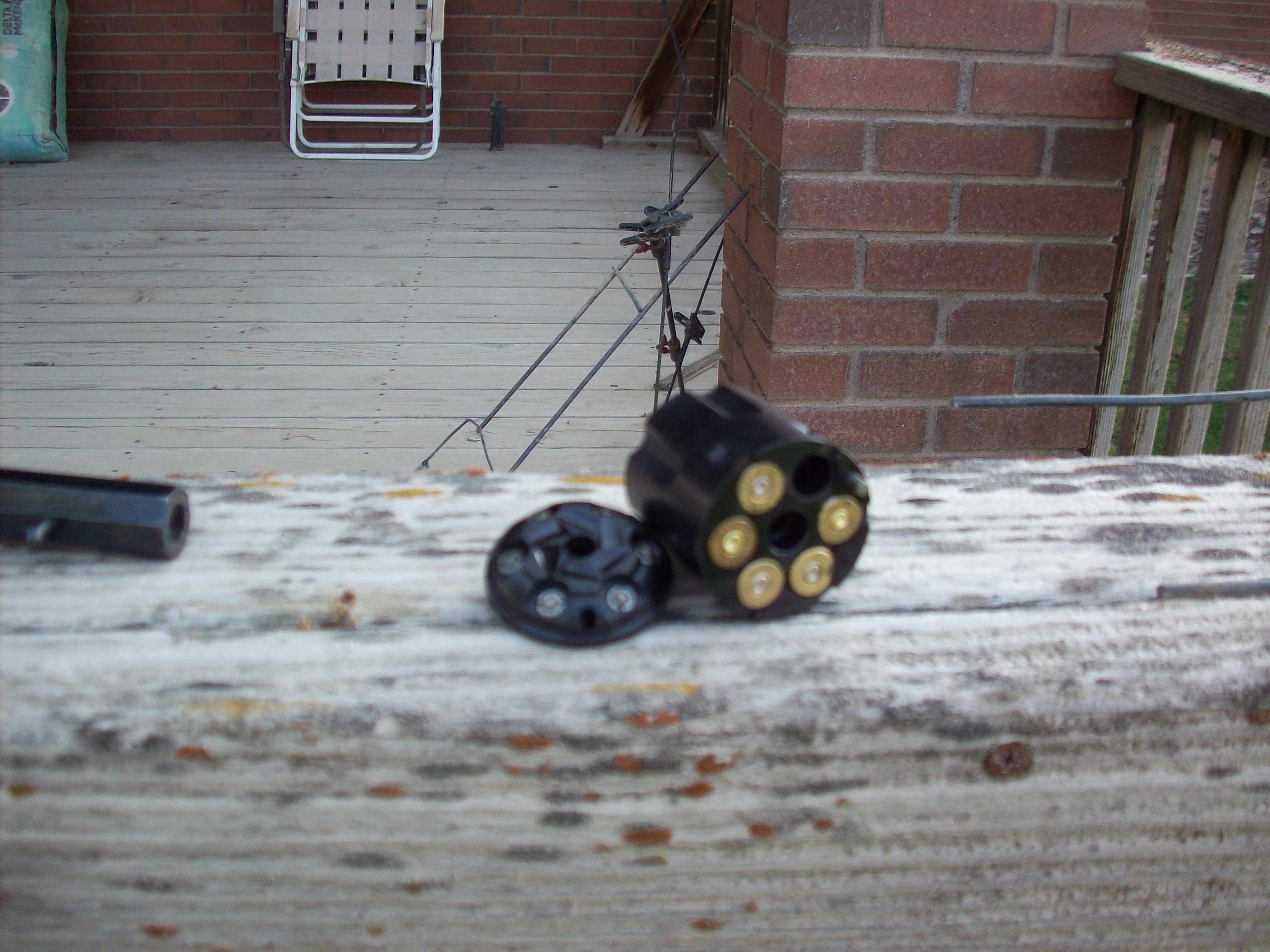

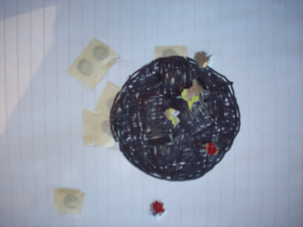

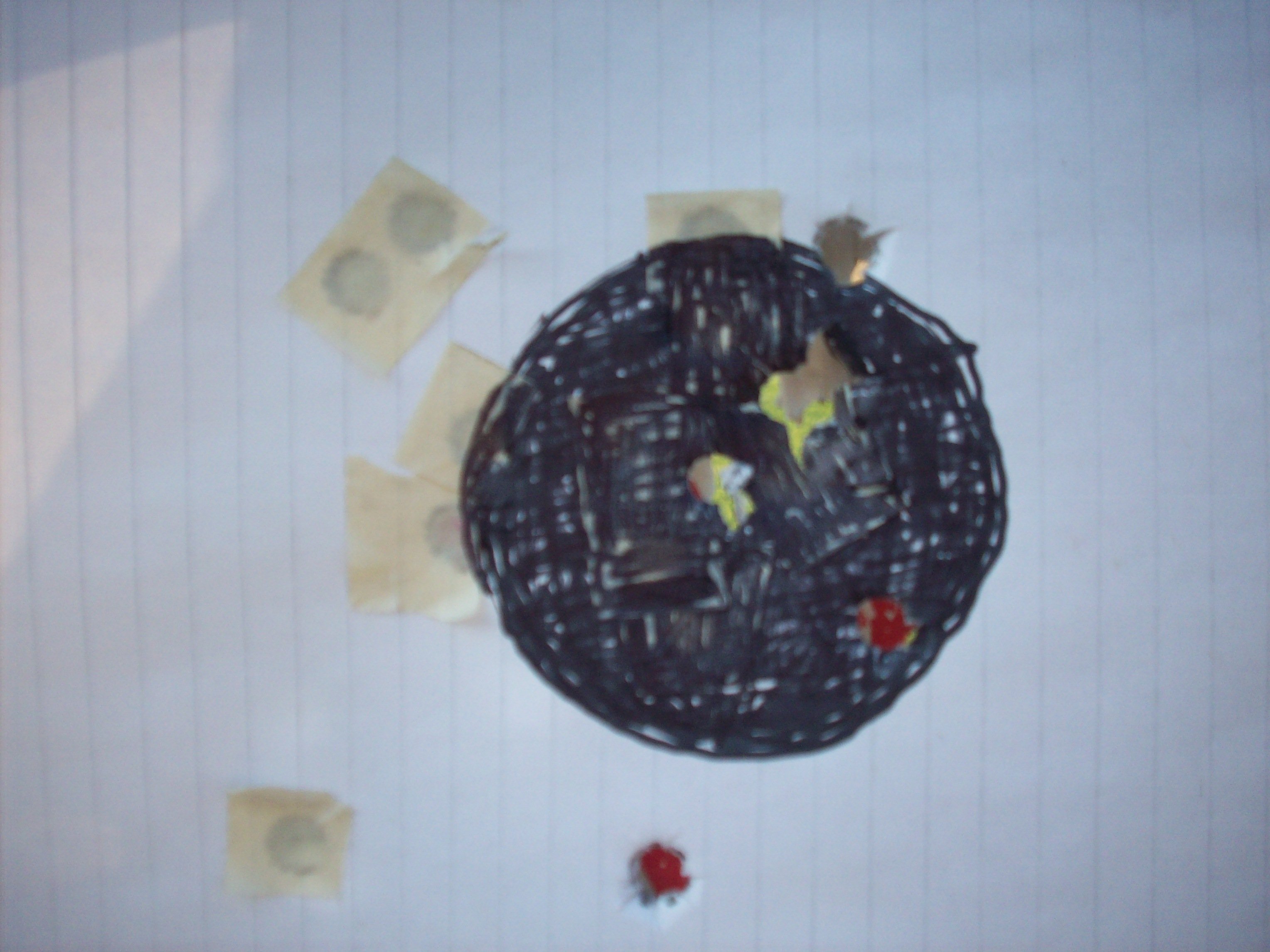

I have a pietta 36 cal 1858 revolver, With cap n ball shoots very well. It will shoot about 1 1/2 inch group at 50 feet maybe better in someone else's hand. I bought a howell conversion cylinder in 38 spl. At 25 feet it shot about an 8 inch group and many hits were key holes. I obtained a sample of Bear Creek Supply 38 cal 358 dia. 150gr RNHB molly coated bullets , these were developed for the conversions. At 50 feet my group went to about 2 inches and no key holes. I fired about 10 rds so far with these results after that for fun I tried a cambell soup can and hit it with each round for 5 rds. I will shoot this more to determine if this continues. My normal CAS round is 38 spl with 105 or 125 gr bullets and 3 gr of bullseye. In order to spread the hollow base I used 4 gr of bullseye.

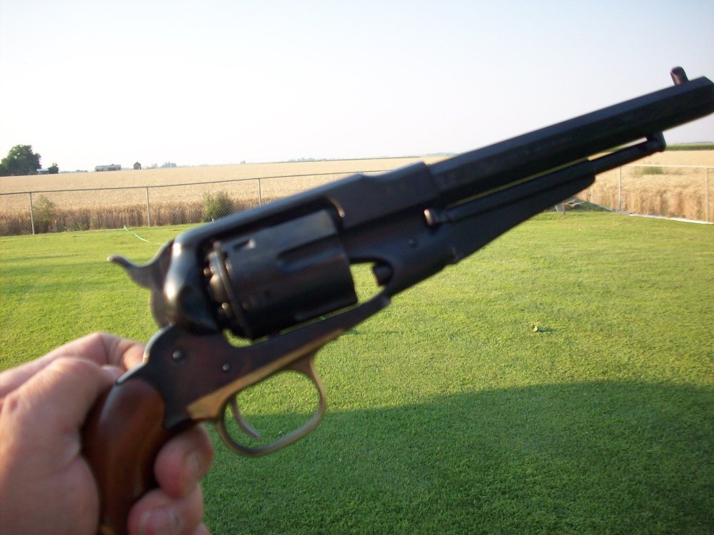

I have a .36cal Pietta 1851 cap n ball made in the 90s. I have a .45 cal kirst conversion loading gate and cylinder. Can the loading gate and cylinder be fit to the .36cal 1851 and a .44cal barrel be added and shoot .45 lc or .45 cowboy or others? Thank you Bullett
